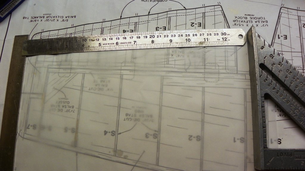

Someone asked me if you could overlay plans and see thru it. I wasn't sure .so I checked and you can. The only problem I had is you can't tape it down ,because the tape won't stick to it. Here's a picture. By the was , I just saw a ad for it on TV.
Re: Parchment paper
Strapping tape will hold it down. I bought a roll of parchment paper today and when I was ready to use it the closest roll of tape was fiberglass reinforced strapping tape. It works. Probably duct tape will work as well. Then there is always baling wire.
Re: Parchment paper
That's good to know. I used masking tape and it wouldn't stick at all.
Re: Parchment paper
I tried Duct tape and it kind of sticks,it might hold long enought to get some pins in it.

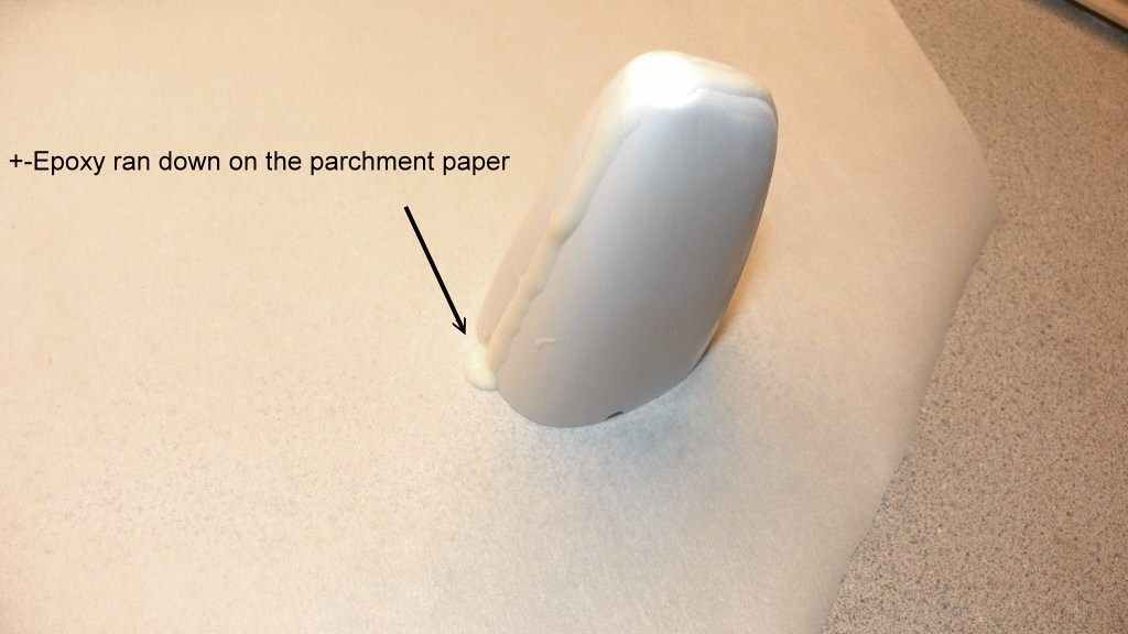

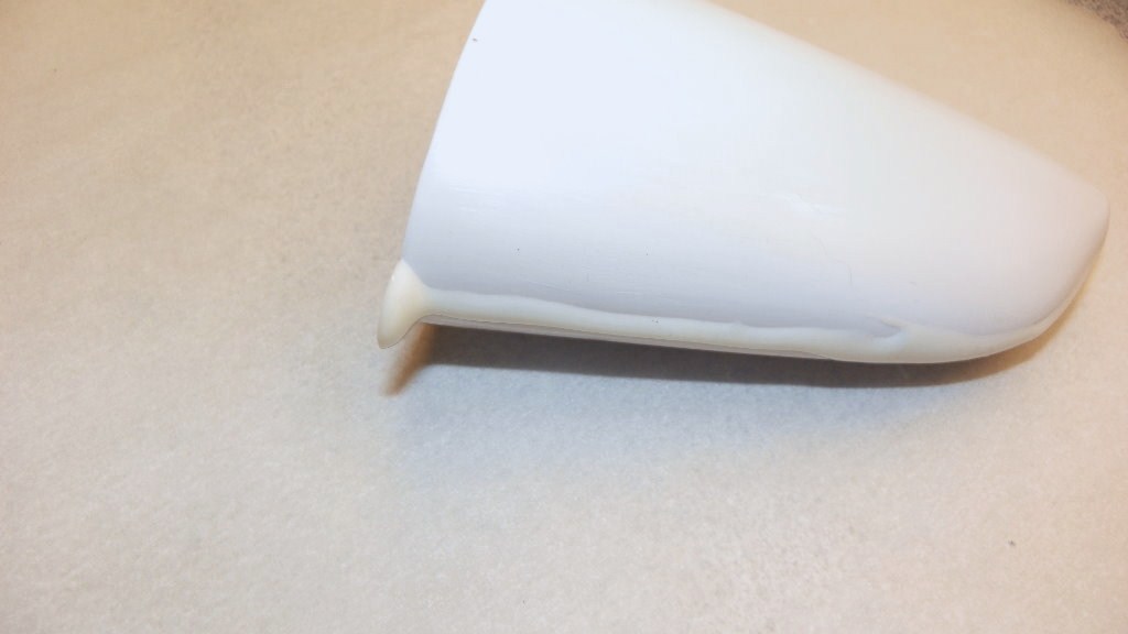

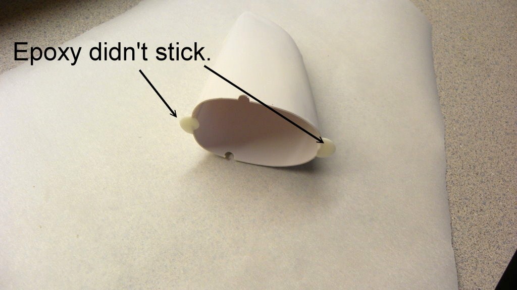

I had to do some filling on the ABS plastic tail cone. I did it on some of the Parchment paper. It worked great ,as the epoxy ran down on the paper and didn't stick. Here is some pictures.
