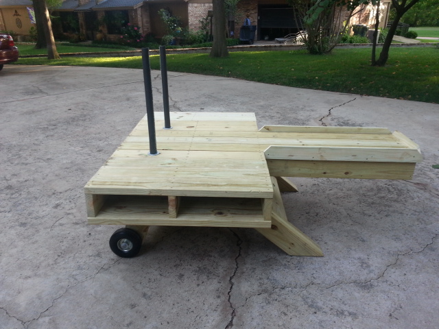

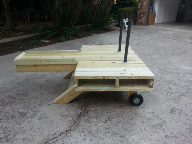

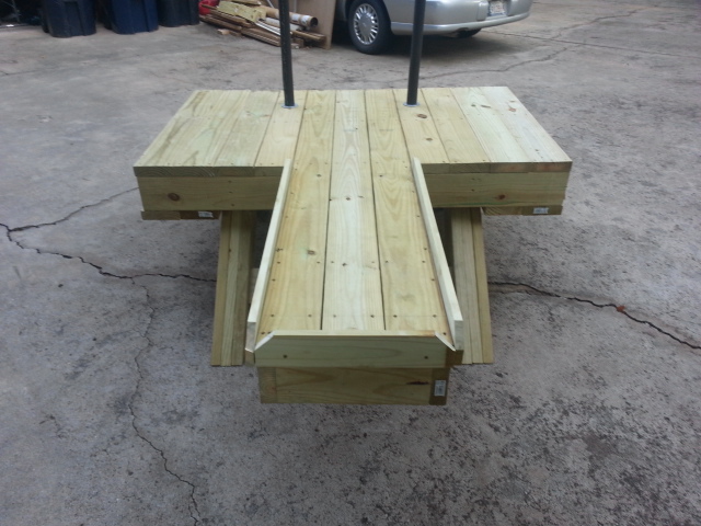

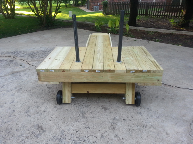

Here are a few pictures of the LG2 safety bench that I built for use at my house. I made a couple of modifications to the plan. One modification was to do away with the wood wing restraint above the table top and replace it with 1/2 inch pipe screwed into a pipe flange. I installed a total of six pipe flanges, 3 on each side. This allows me to make the wing restraints wider or narrower for use with single or multi-engine planes. I also added a storage area on each side of the table with some scrap wood that I had laying around. I also added 8 inch solid rubber wheels with steel rims that I got from Harbor Freight for about $10.00 for the pair.

I like this one as well, the gas pipe uprights are a great idea but I'm afraid the extra storage area would just prove to be a Mud Dobber condominium? We could try one and see if that happens?

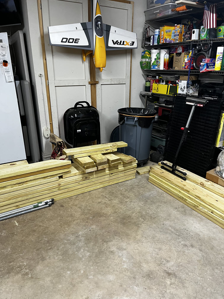

Post by L82fly » Fri Oct 28, 2022 9:08 am

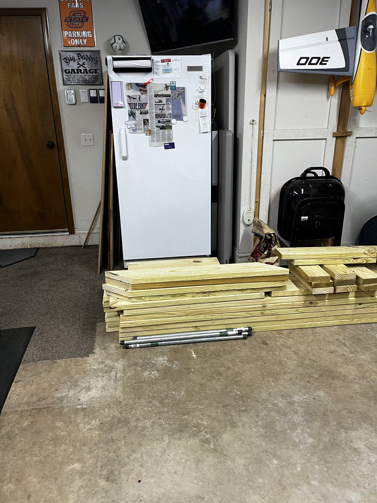

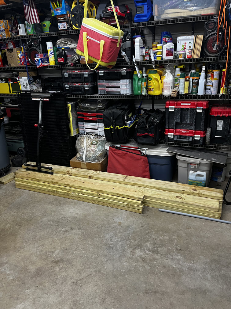

Raw materials getting cut to fit, we should have bought the ARF version :P
Wing kit
Fuse
More sticks....Where does this end?

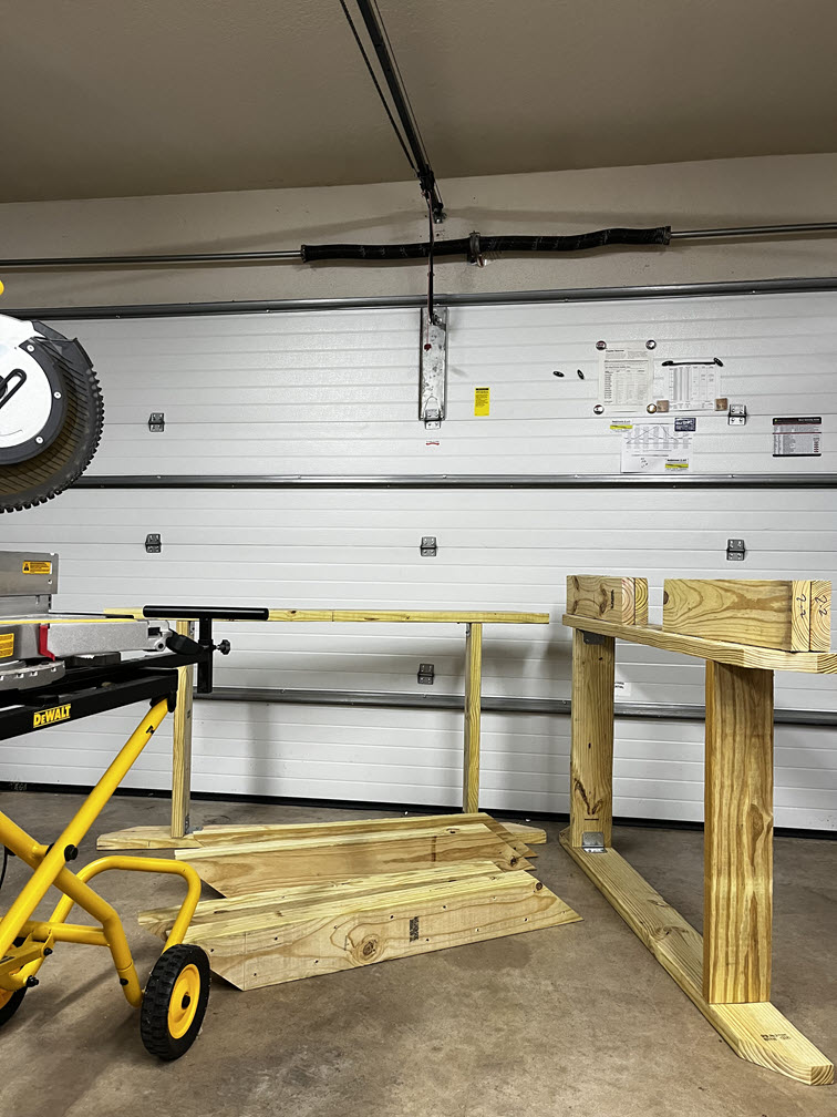

Here's a few more pics of the progress....

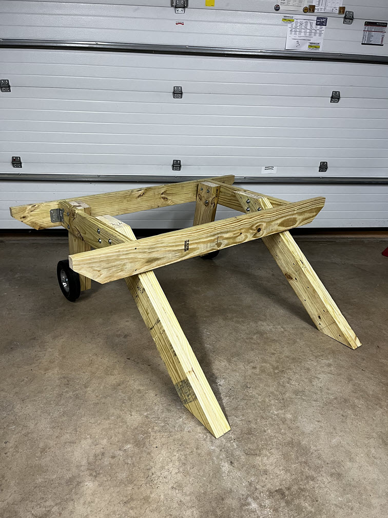

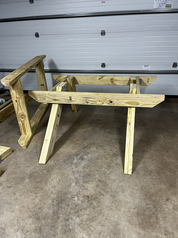

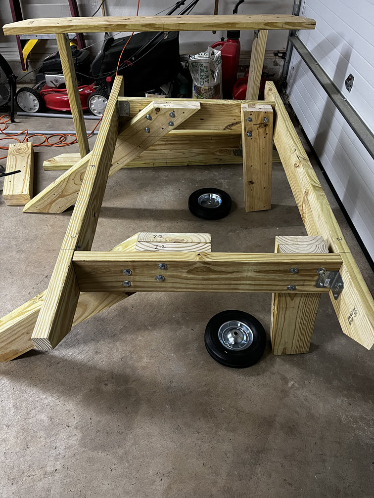

Creating sub assemblies
Frames for the deck

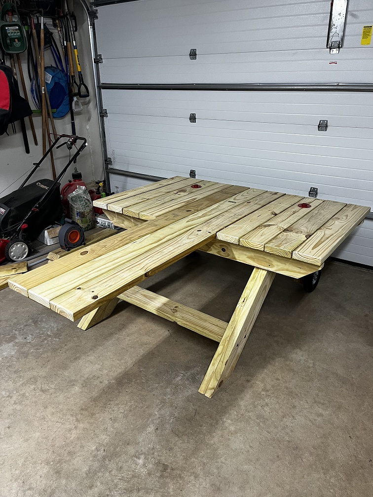

Bigger than I thought it would be, BTW it's really heavy!
Ball bearing wheels rated at 250 lbs. each!
First sub system completed, 10" wheels installed...Yeeha!

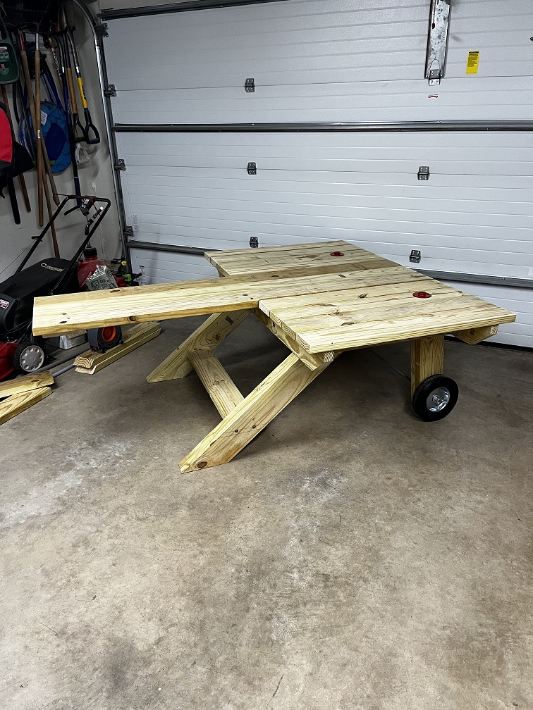

Post by L82fly » Sat Nov 05, 2022 10:57 am
The primary bench code named "Big Dog" is completed except for the vertical hardware and some additional bracing which will be installed with the smaller bench.
Just existing the assembly line
Although heavy it's relatively easy to move since we have it so balanced!!
I think we exceeded the manufacturers specs in using this!
