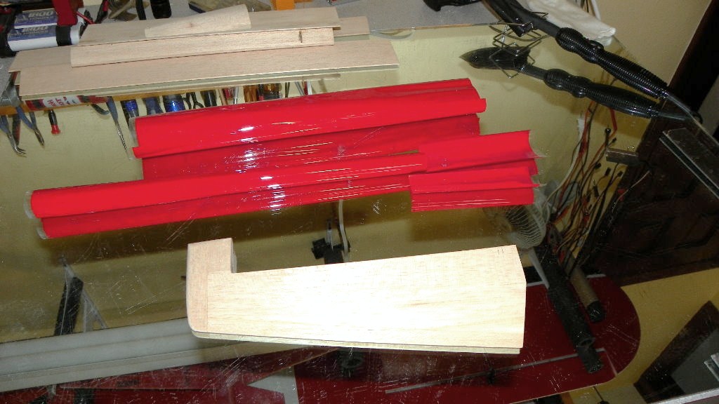

I haven't got much done on the Cessna , But I did decide on a color scheme. It's a Cessna 182R Skyline II that the Coast Guard has. I wanted something a little different than the standard color schemes. I ordered the Monokote. I have a lot of prepping and sanding to do. So not much in the way of pictures for a while. Here is a picture of the color scheme.

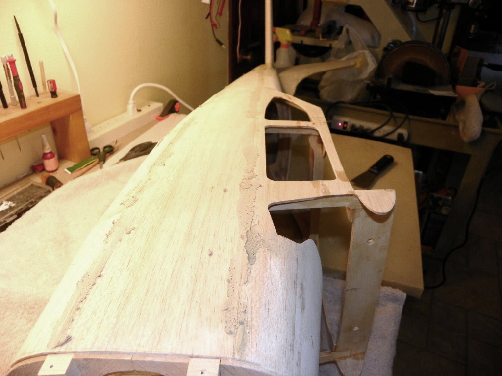

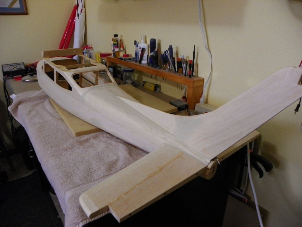

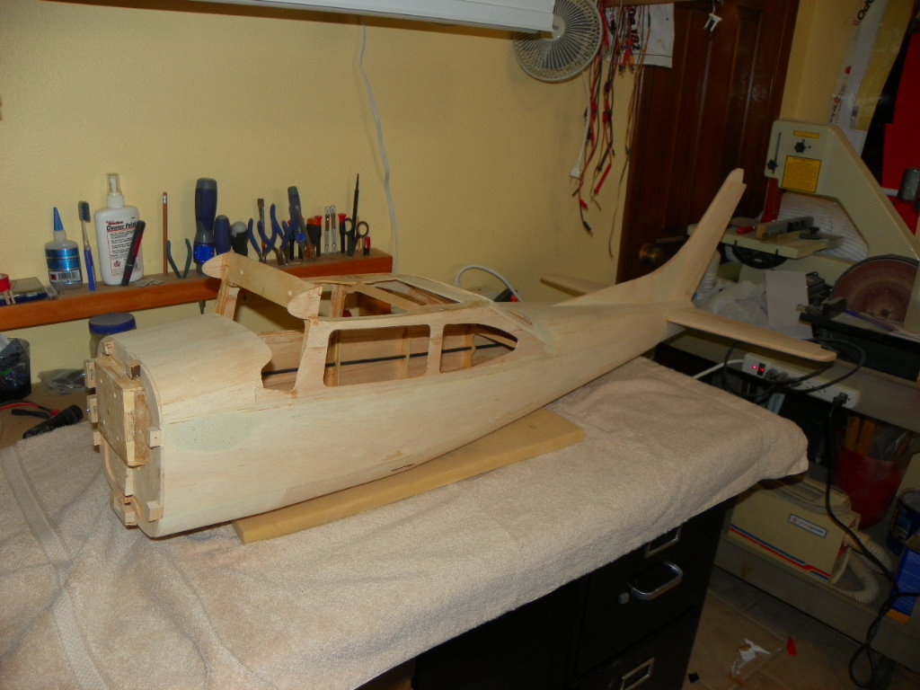

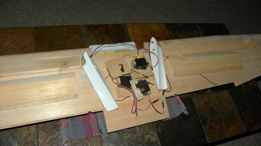

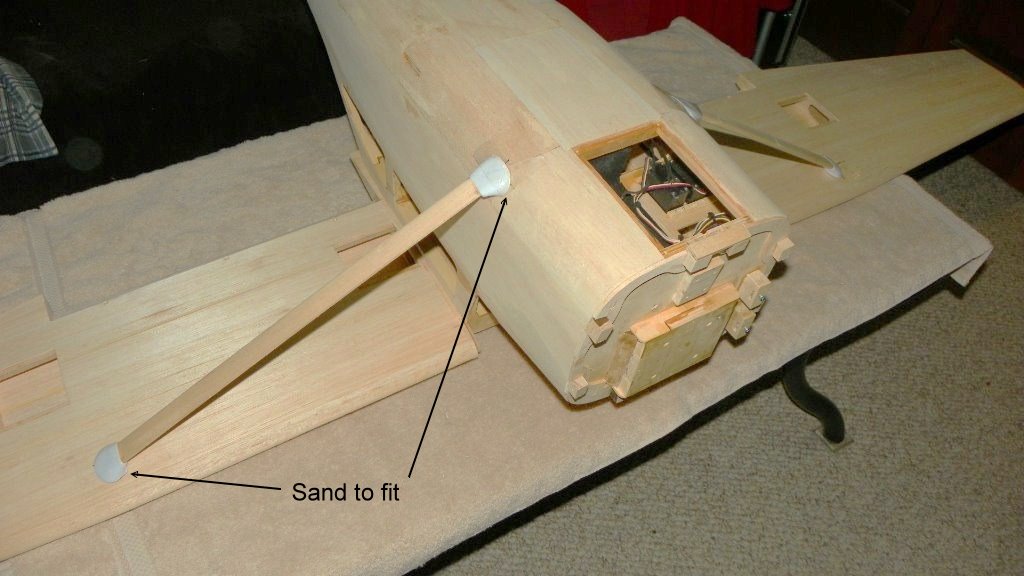

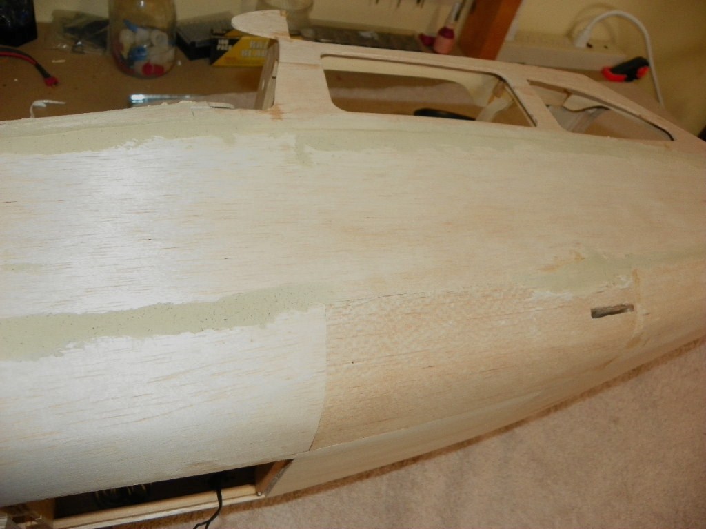

Here is some pictures of the 182 almost ready to cover. I did some filling and sanding getting it ready to cover. I just want to get the wing struts done before I cover it and will be doing that next.

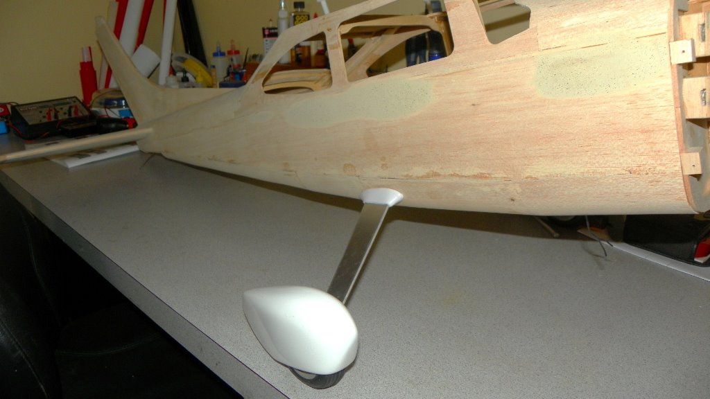

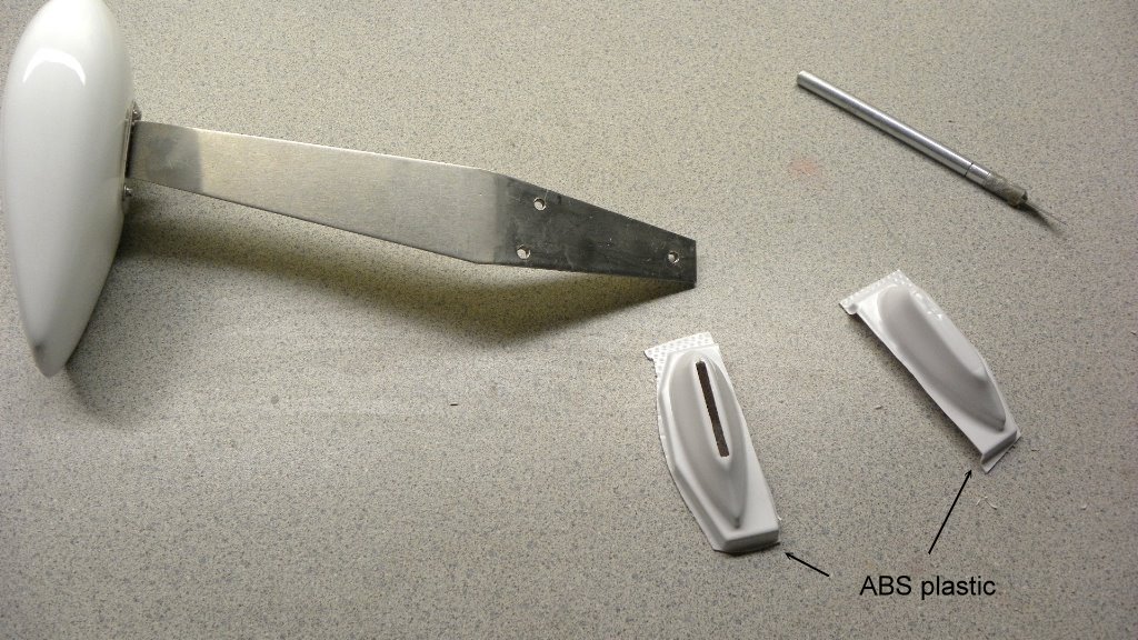

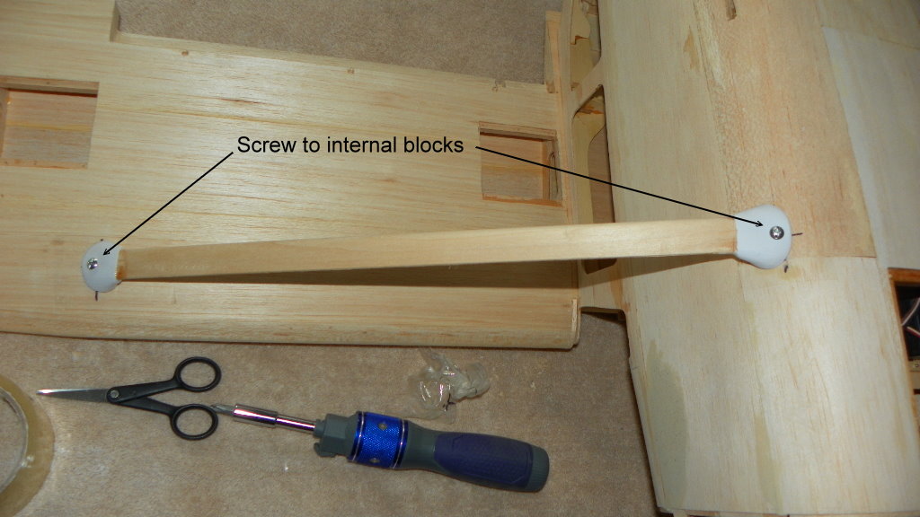

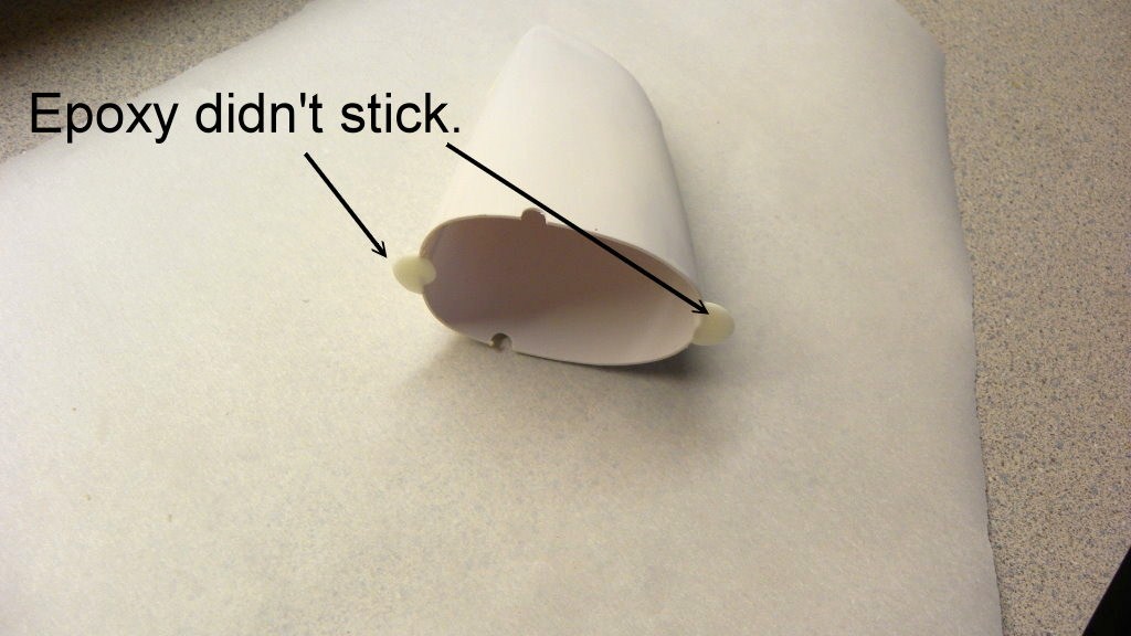

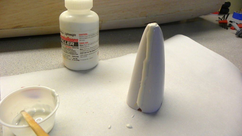

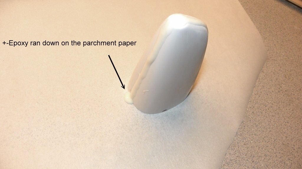

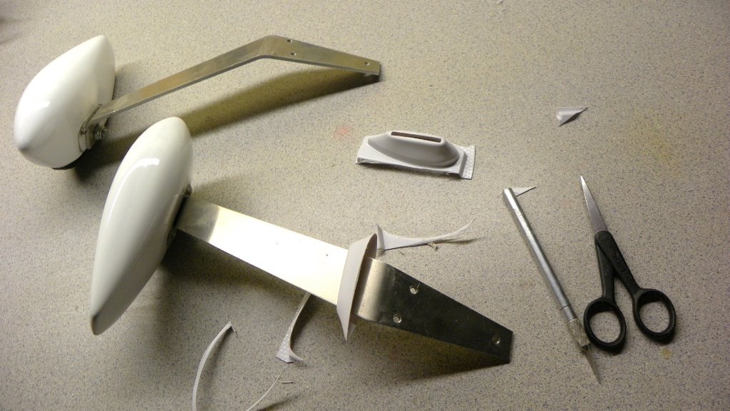

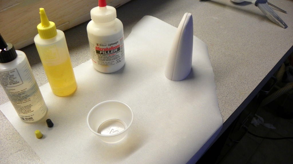

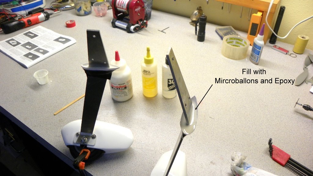

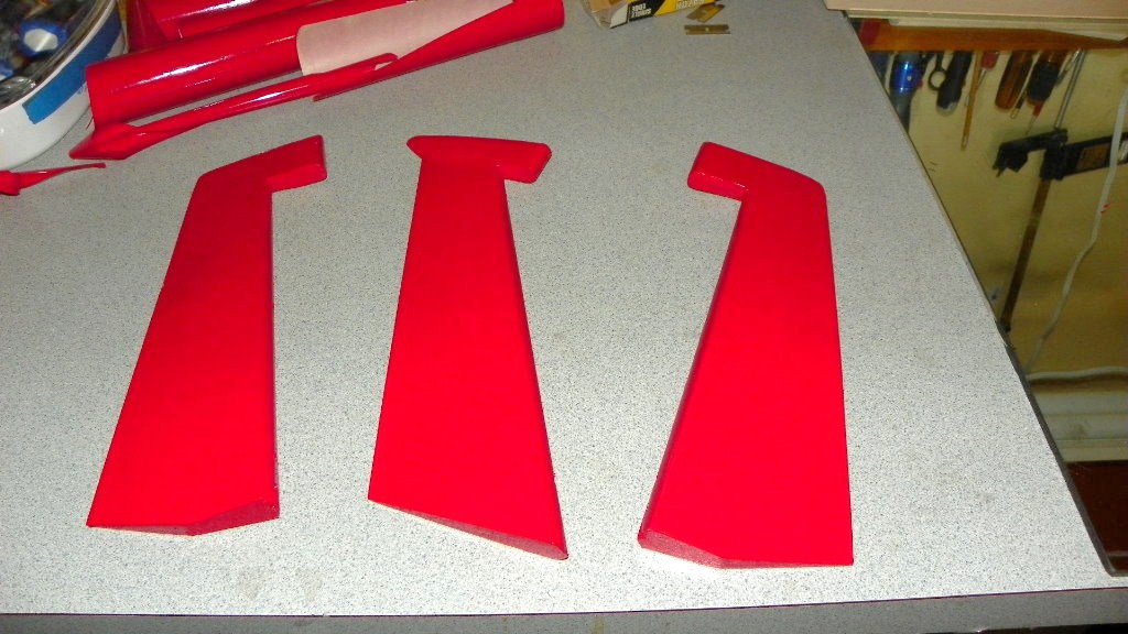

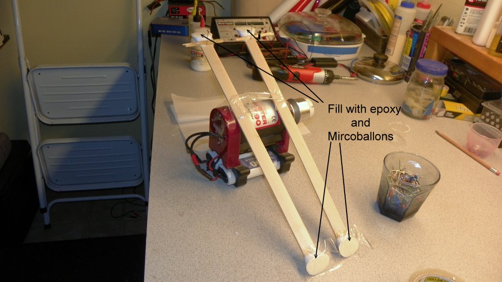

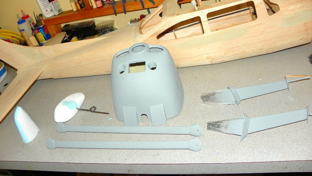

I worked on the wing struts. The kit came with ABS plastic strut flaring that had to be cut out and fitted to the struts and the body and wing. Then you have to fill them with Epoxy and Mircoballons and refit to body and wing. They came out fairly good , all things considered.

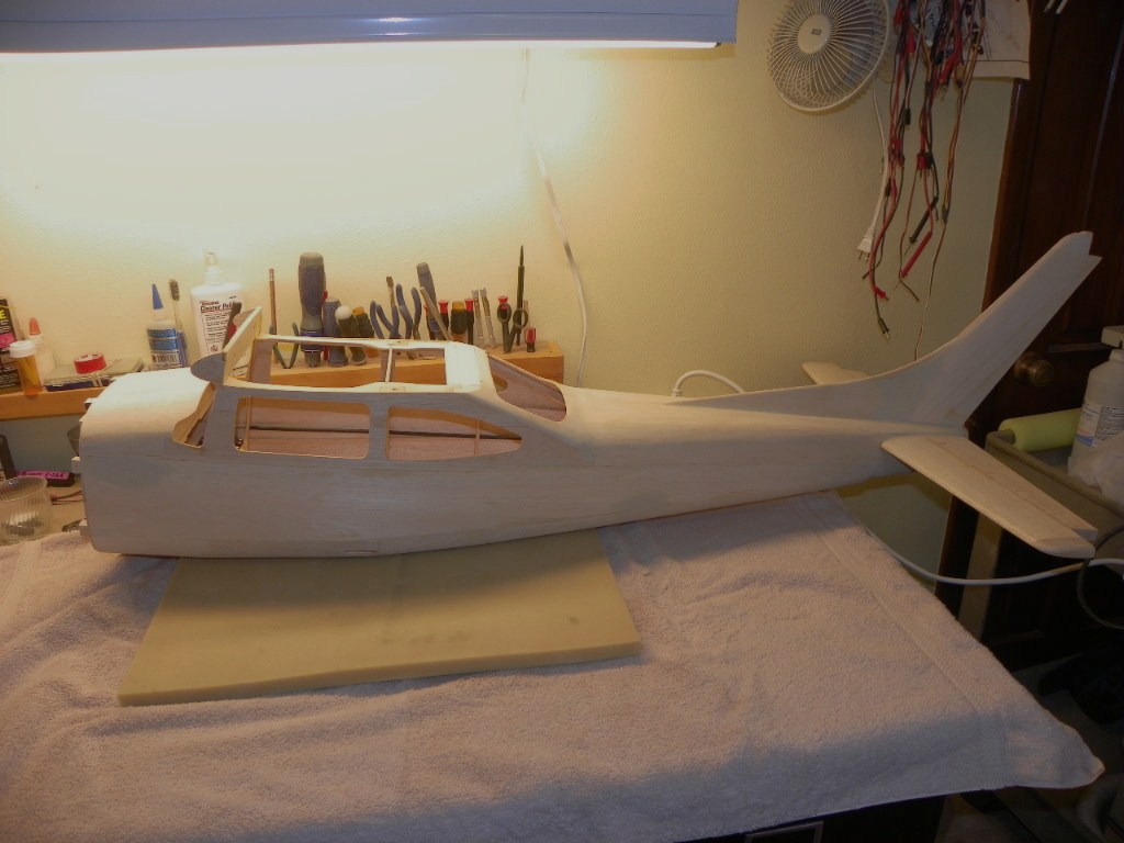

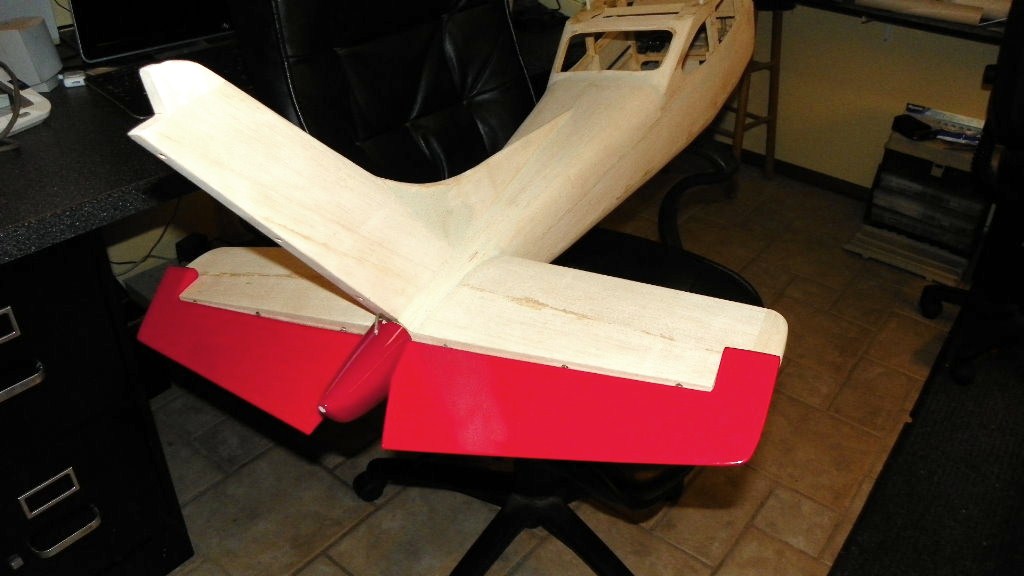

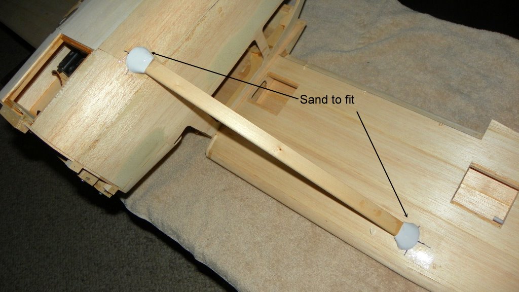

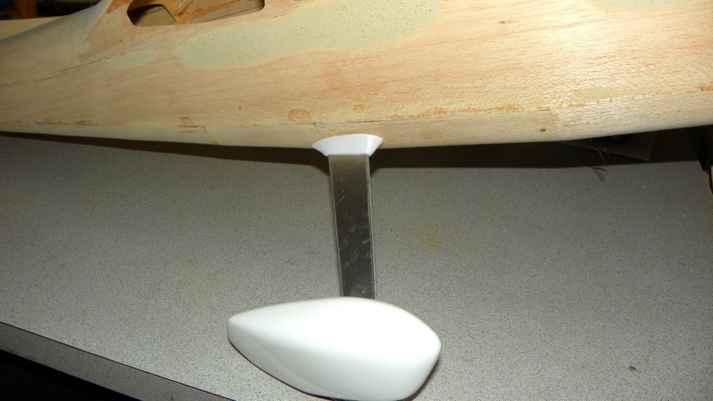

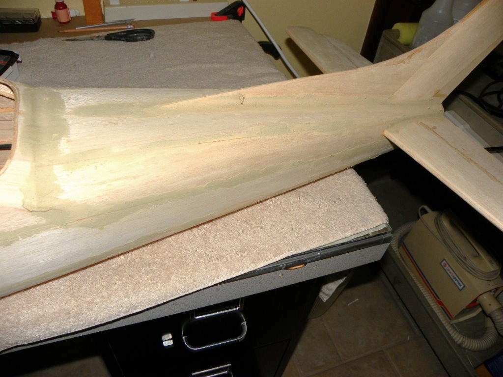

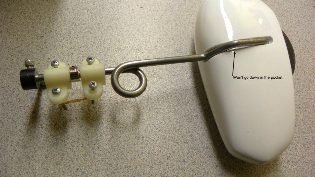

I worked on the flaring on the landing gear. More trimming and filling ABS plastic.

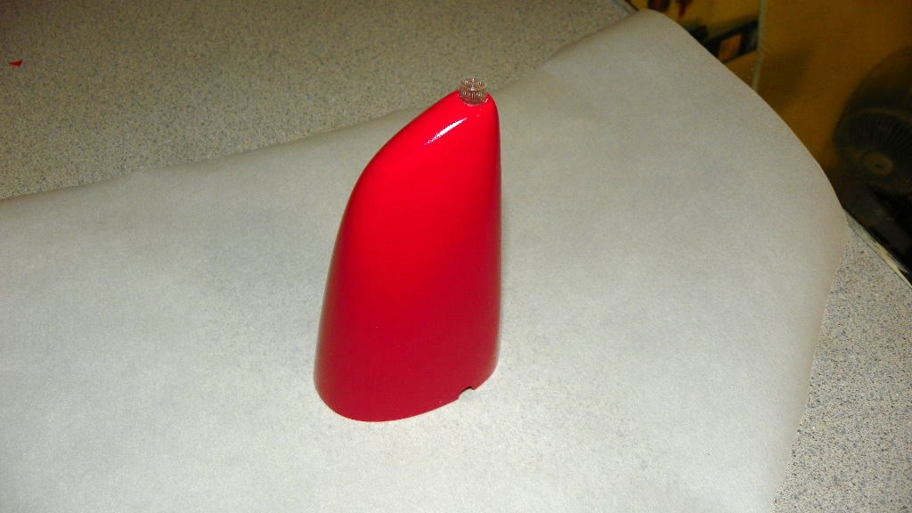

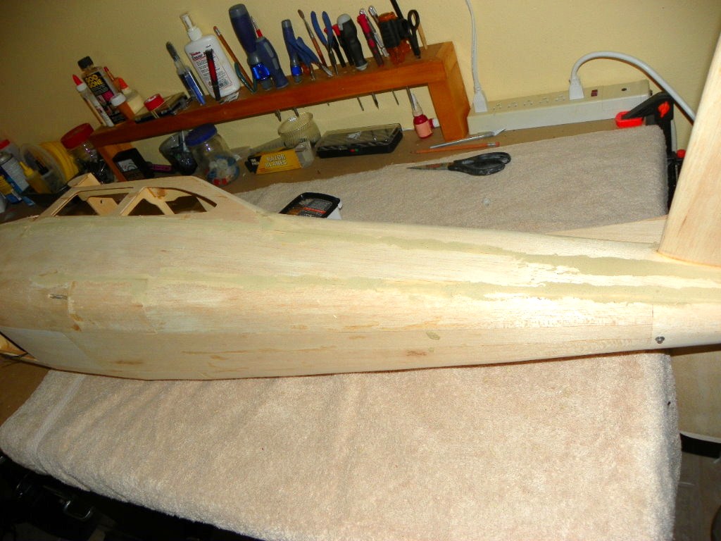

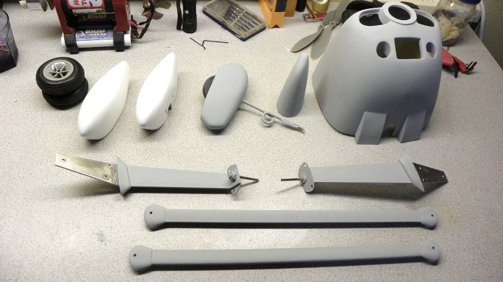

Well thanks to the cold weather I got a little work done on the Cessna.Here's some pictures.

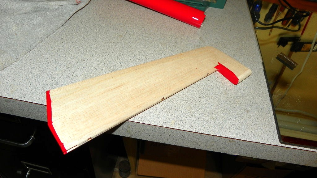

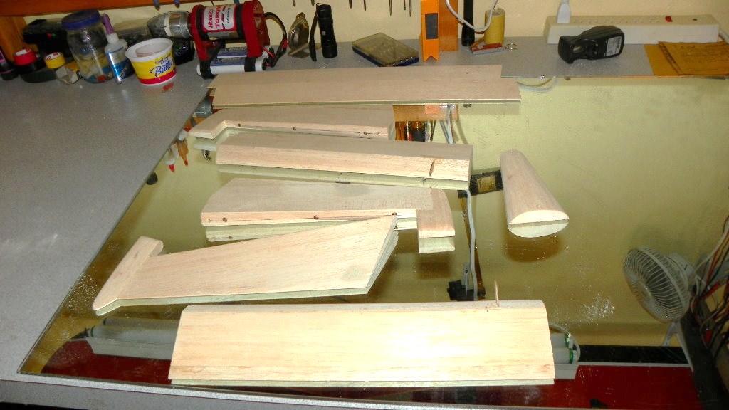

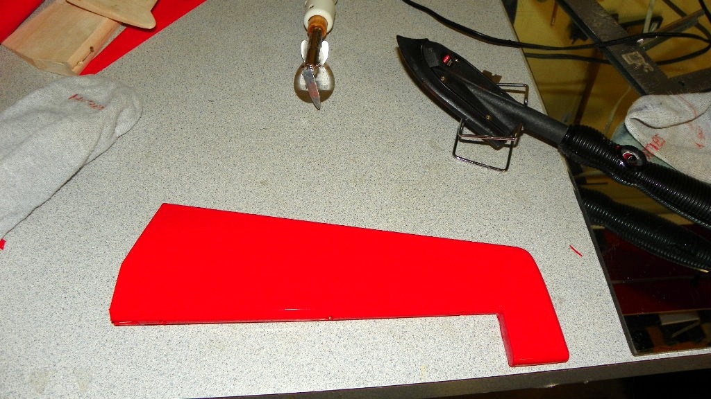

The more I work on the Cessna , the more I see that needs to be done. I finally got started on the covering . I will be doing it a little at a time, while working on some detailing of the parts. The ARF parts I bought needs to be sanded and primed to get them ready to paint to the new color scheme. I've decided to go with the Coast Guard color scheme. The one I found is from New Zealand .It's in the Auckland Coast guard. It's the one I found the most pictures of. Their Web Site is http://www.coastguard.org.nz/auckland_a ... d23f4a8de2
