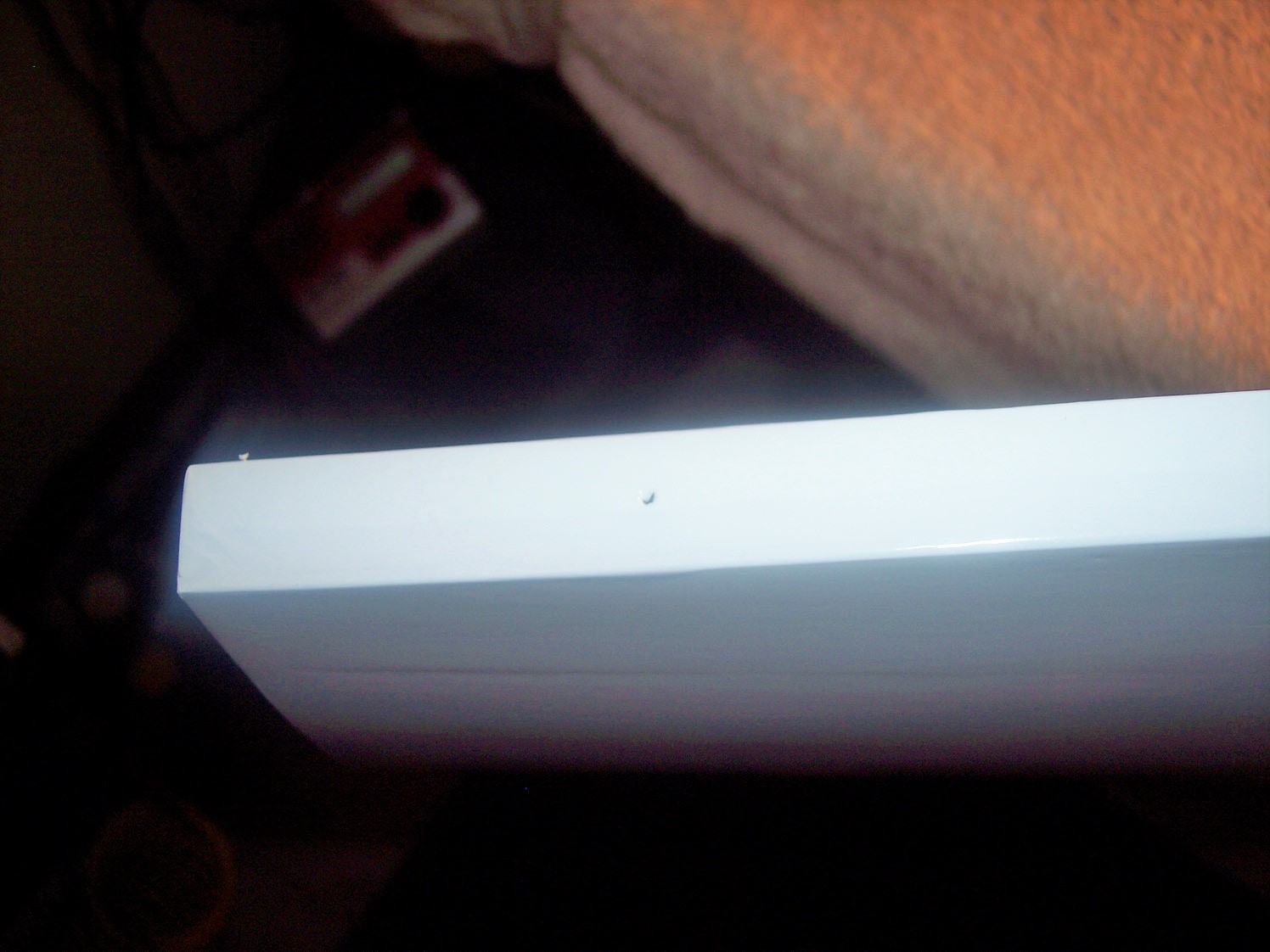

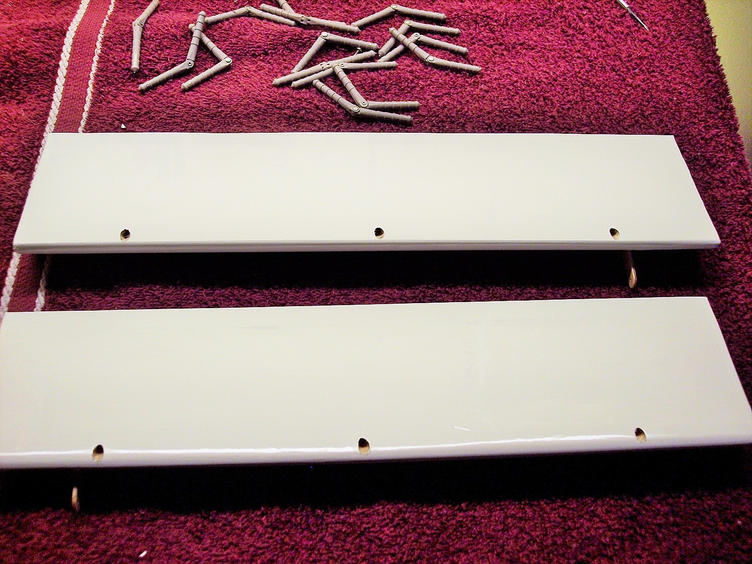

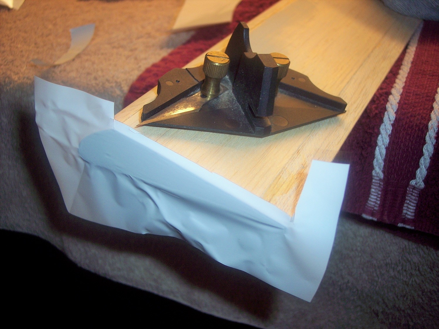

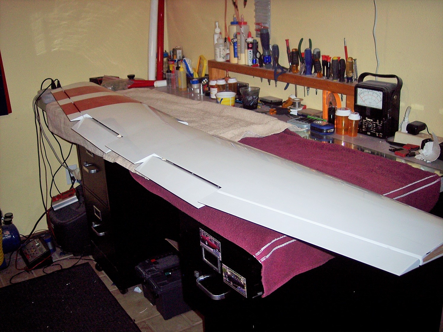

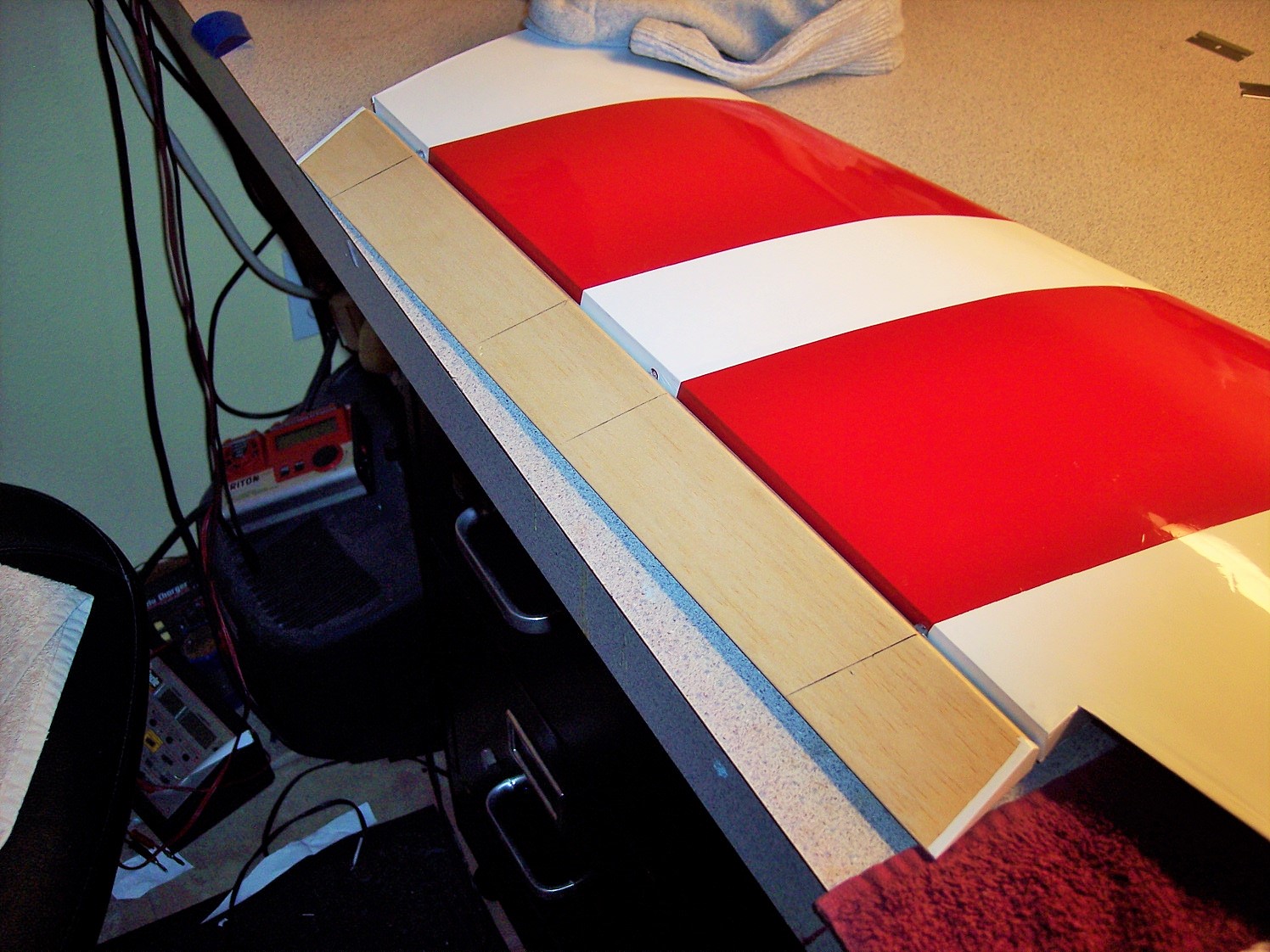

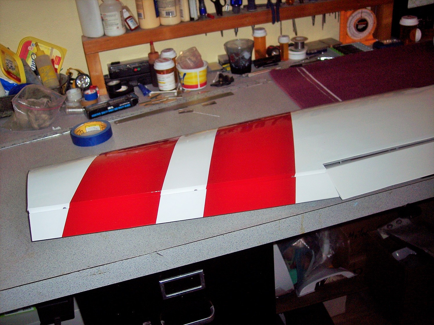

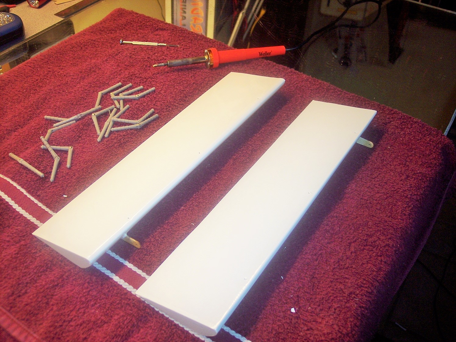

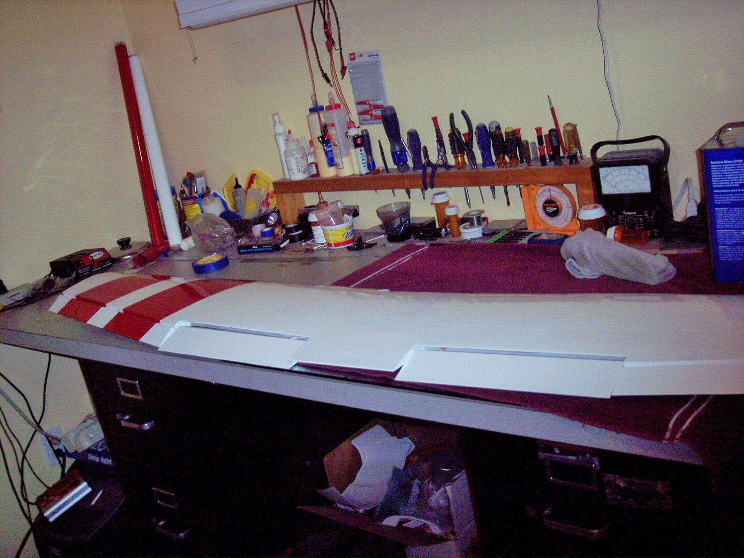

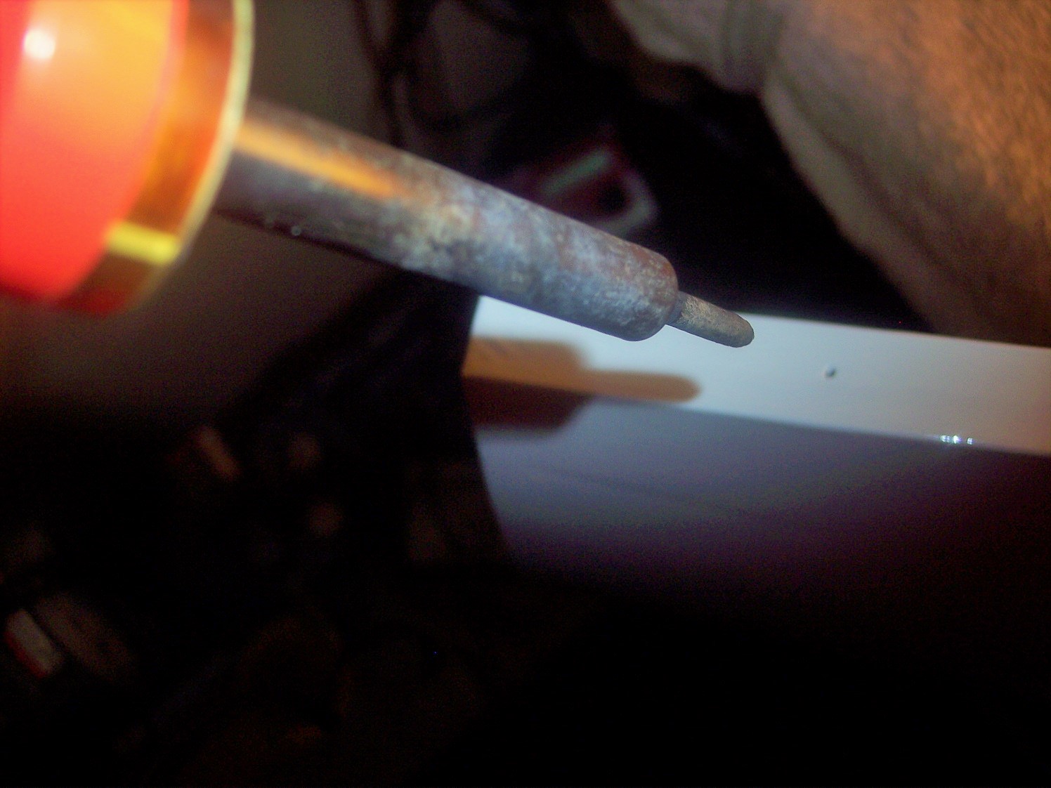

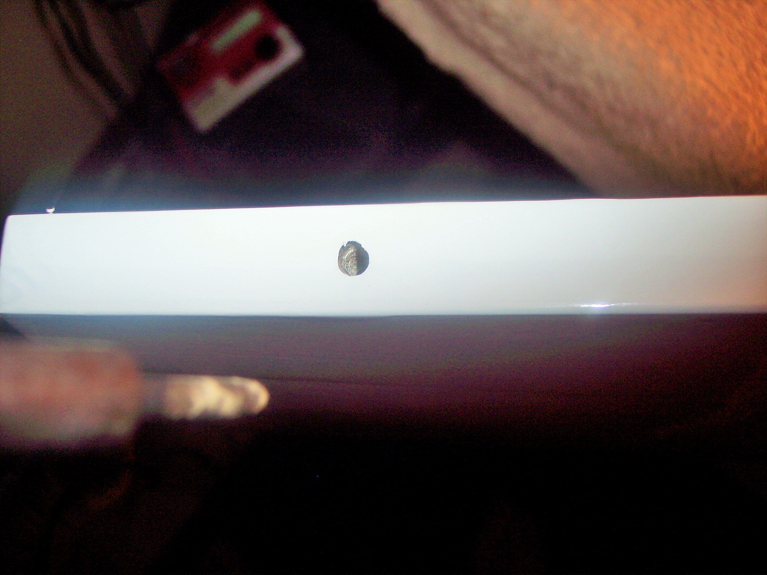

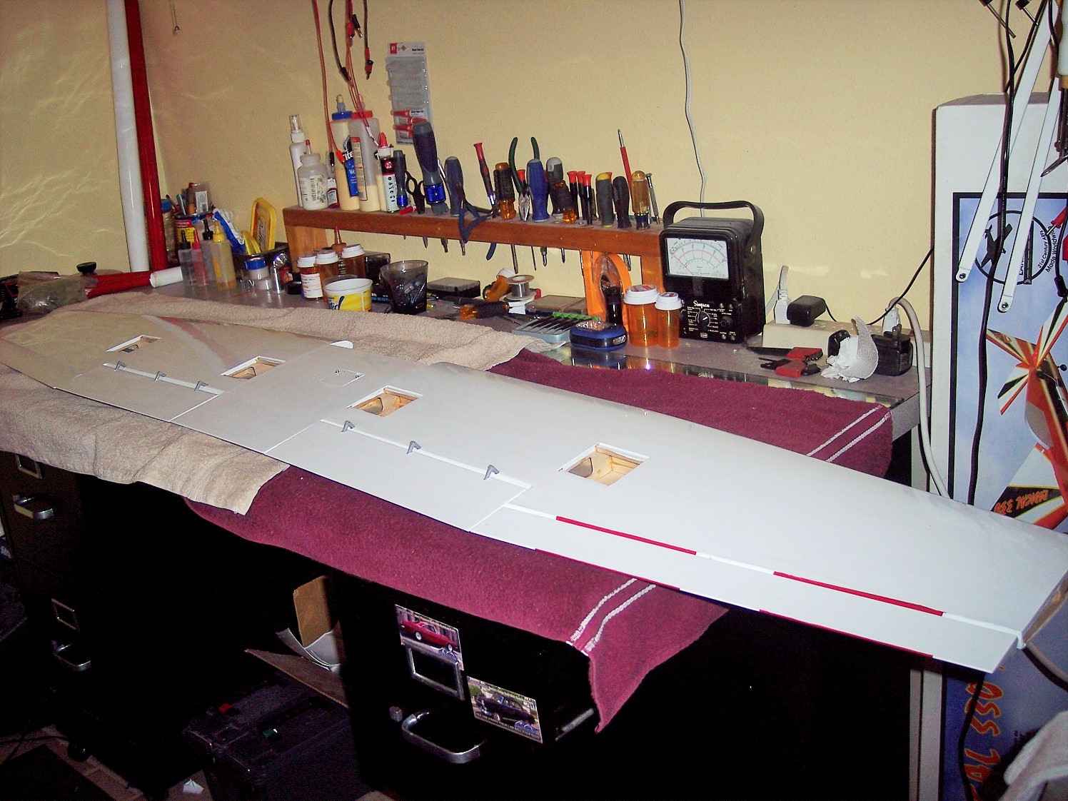

I got the Flaps covered. Next is the ailerons and that will be the last of the covering. :D I also found a easy way to clear the Monokote that covers the holes for the pin hinges. I used a small soldering iron and burned out the covering. It made a nice clean hole.
Post by kdoughty » Sat Mar 11, 2017 6:23 pm

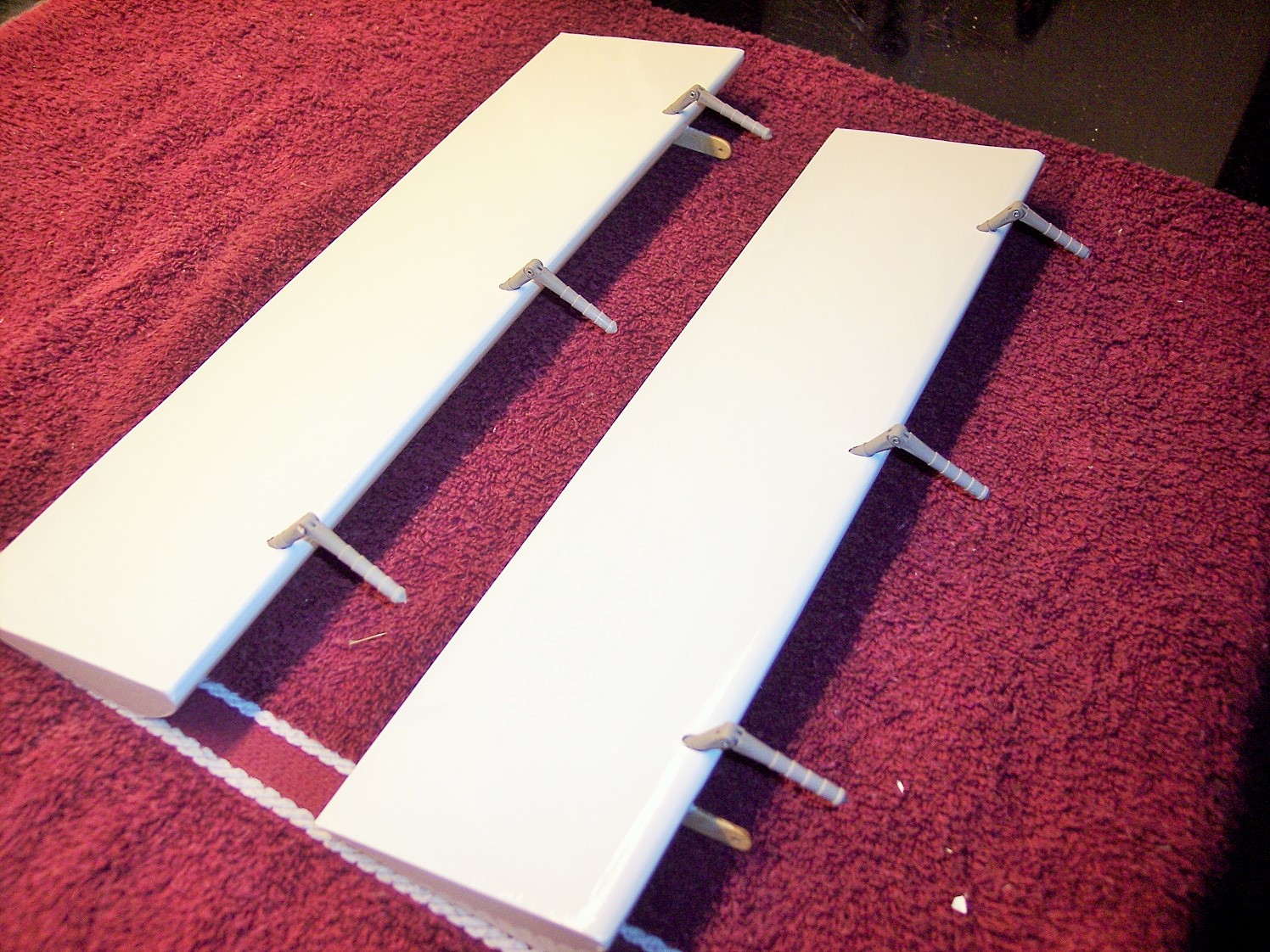

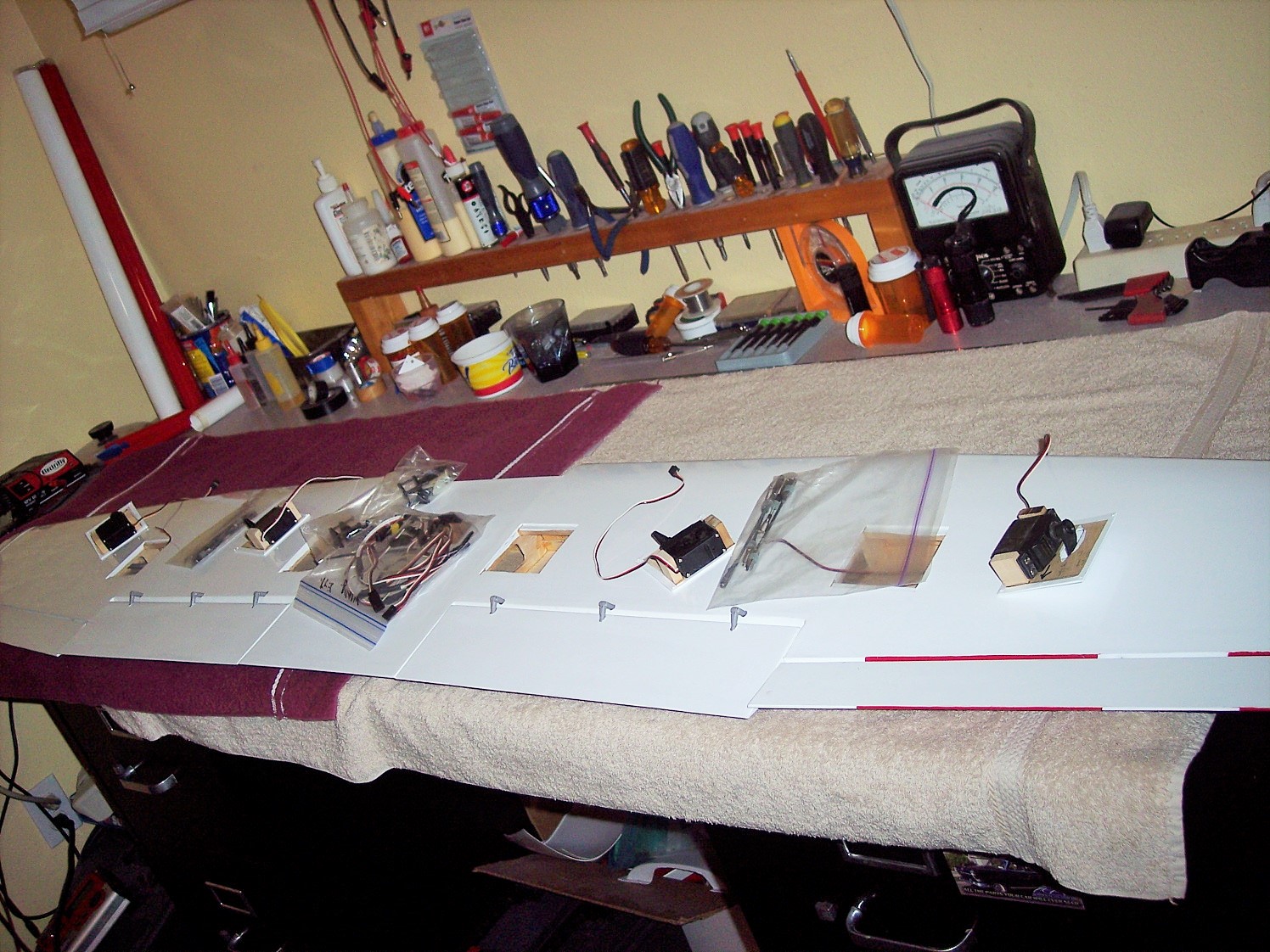

I'm finally finished with the Monokote. :roll: Next I need to clean up the room and get ready to install the Flaps and ailerons and then the servos , control horns and push rods.

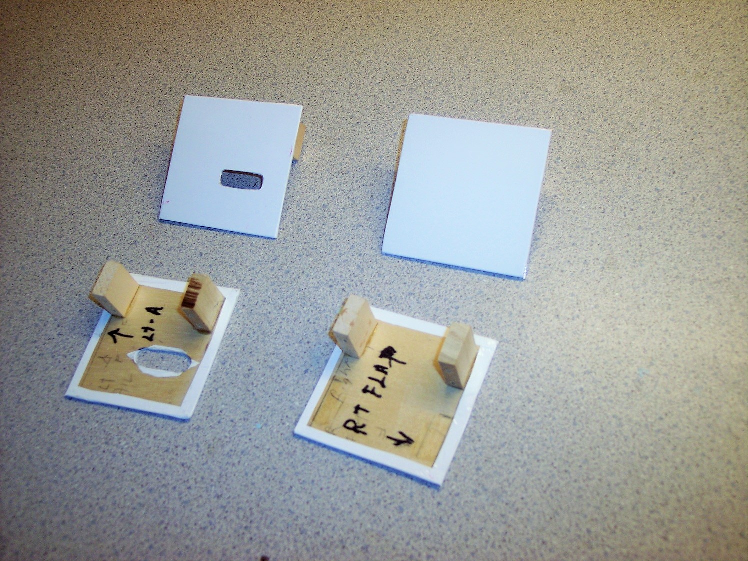

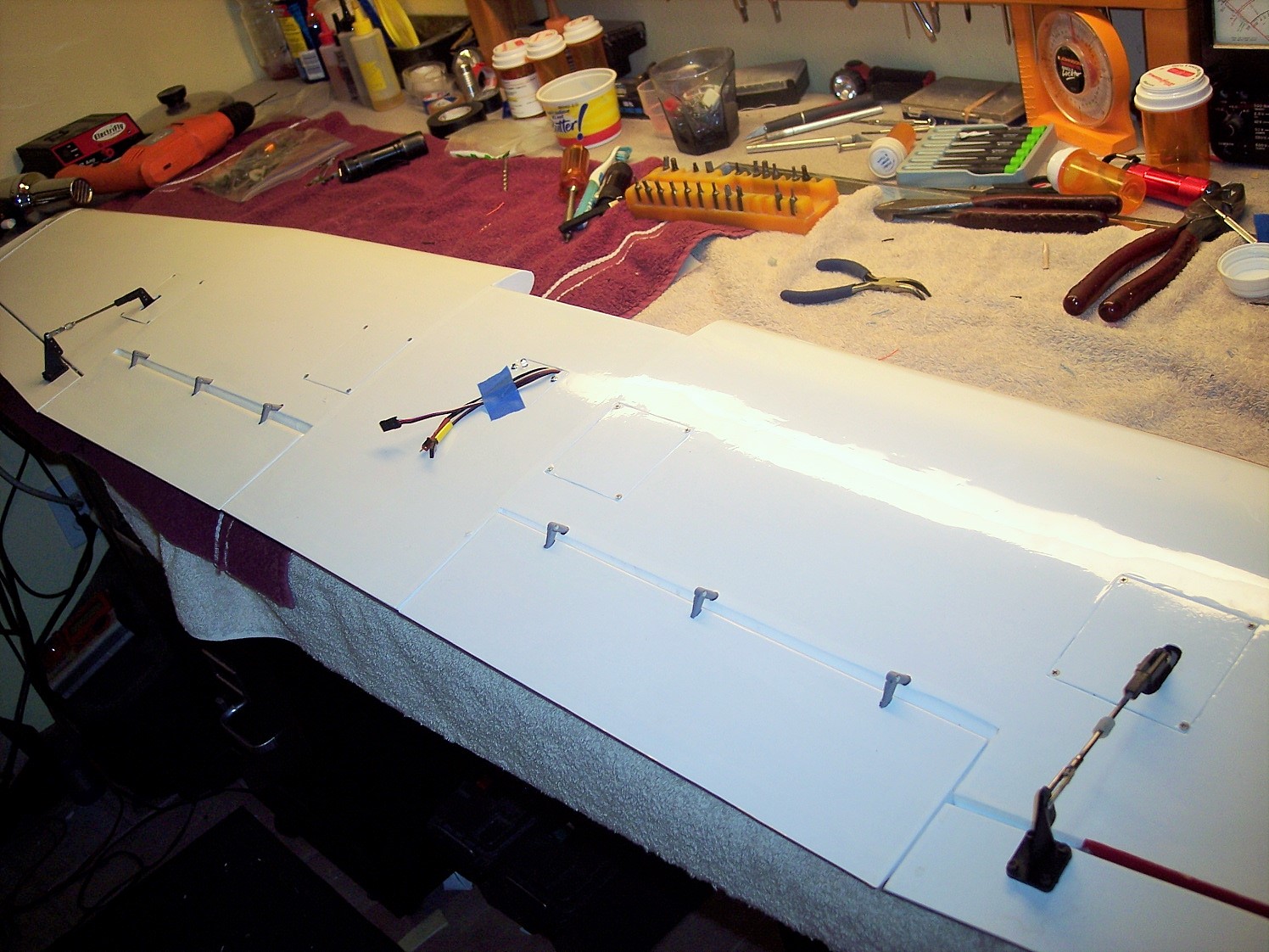

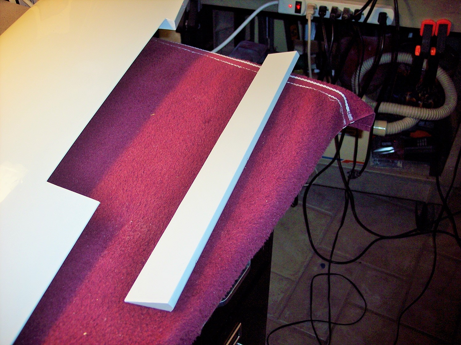

I got the Flaps and Ailerons Epoxied in place. Next comes the wing tips. At this point, it's like working on an ARF.

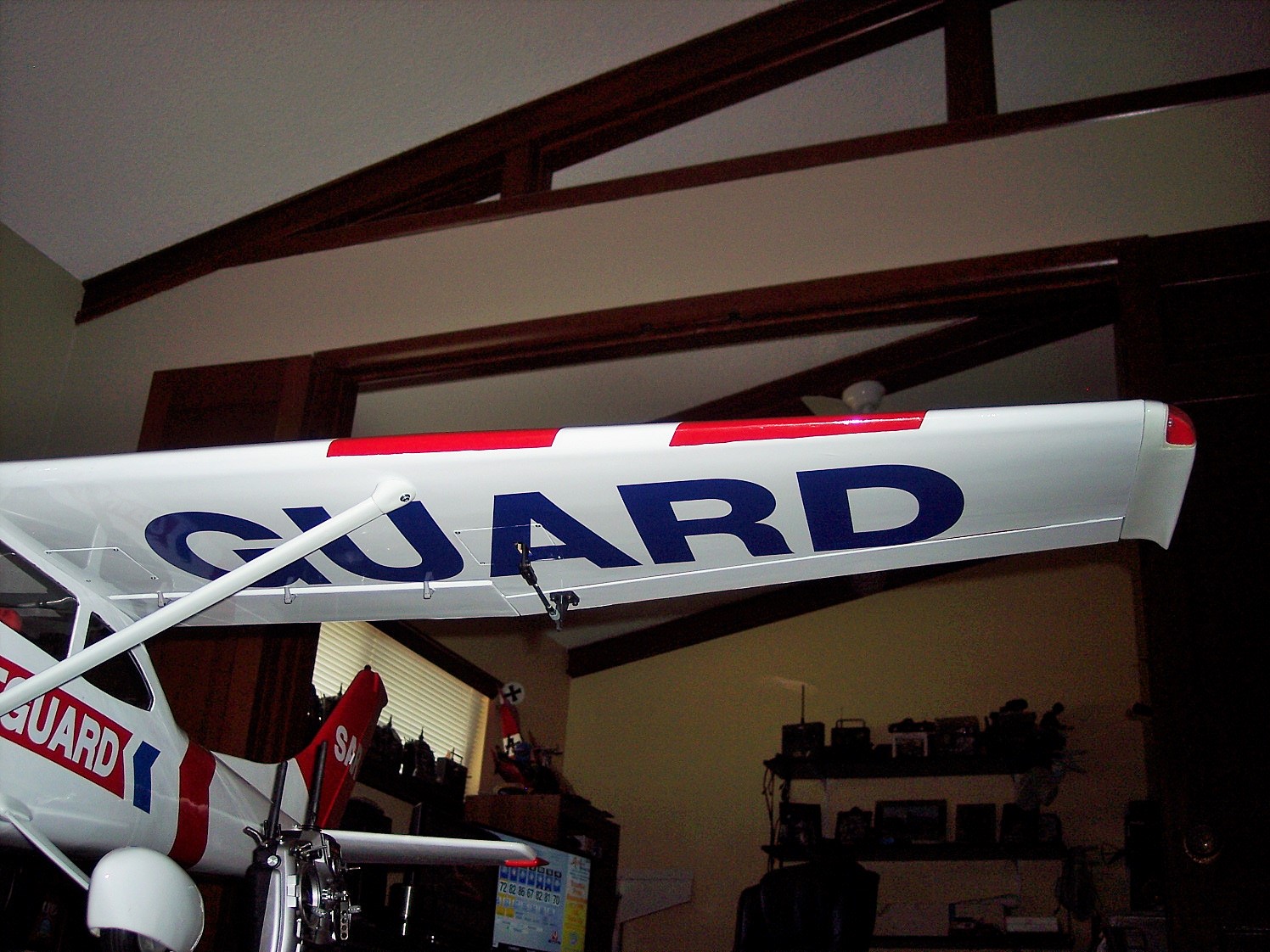

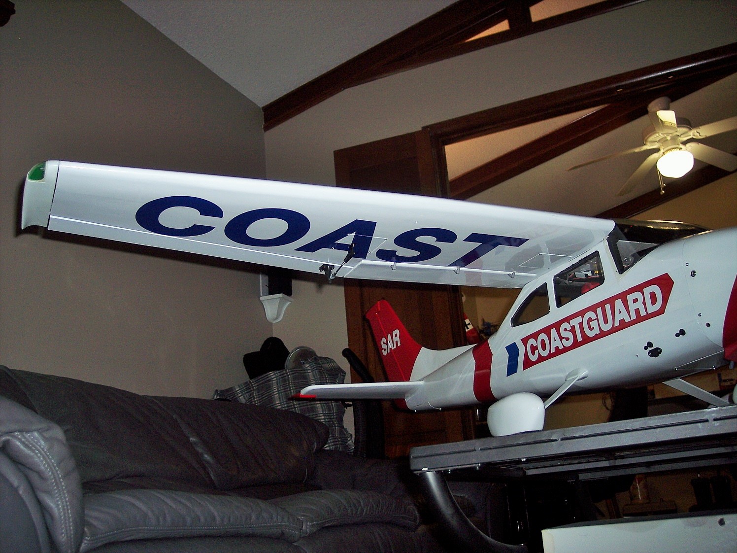

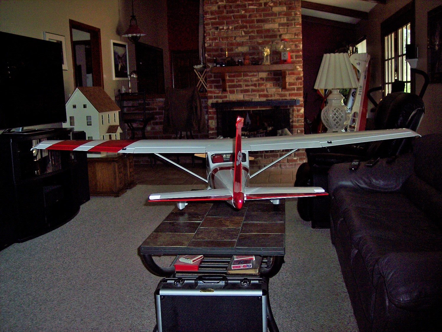

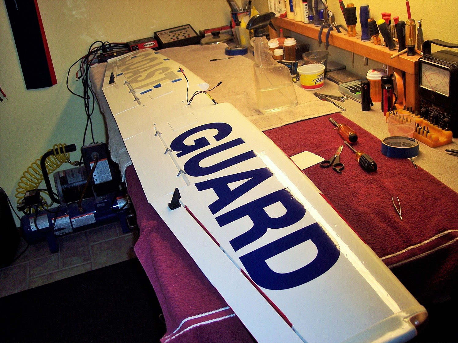

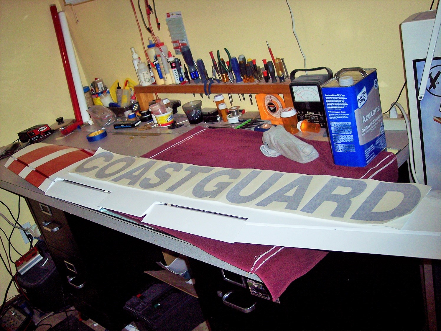

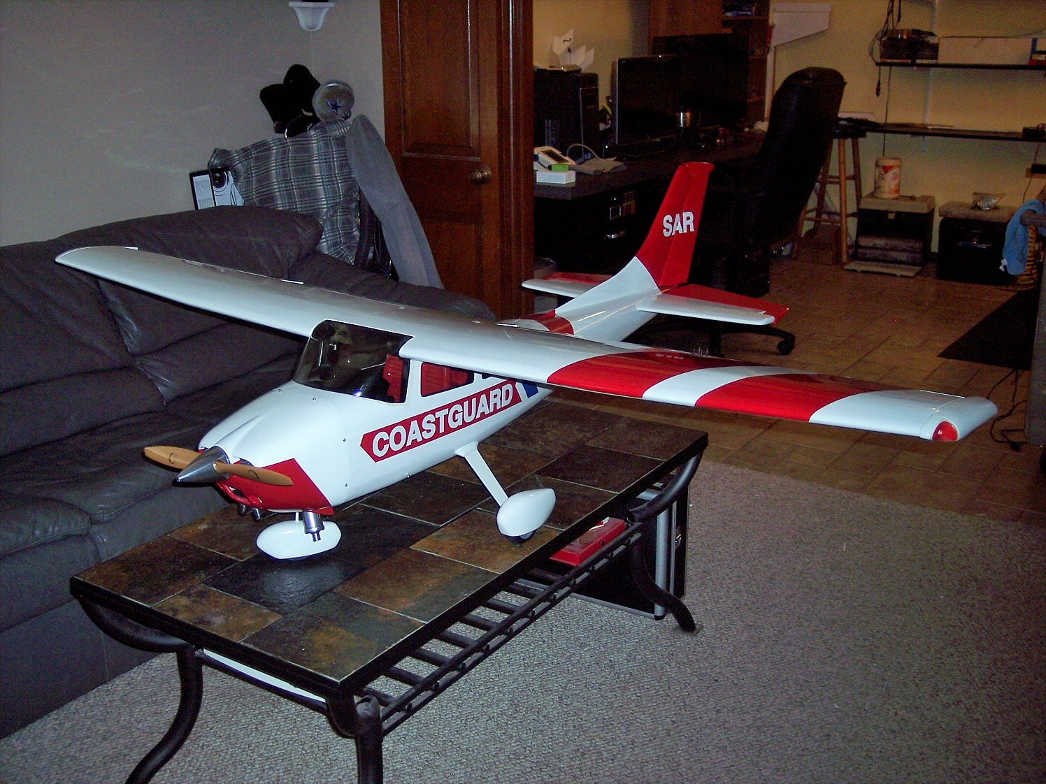

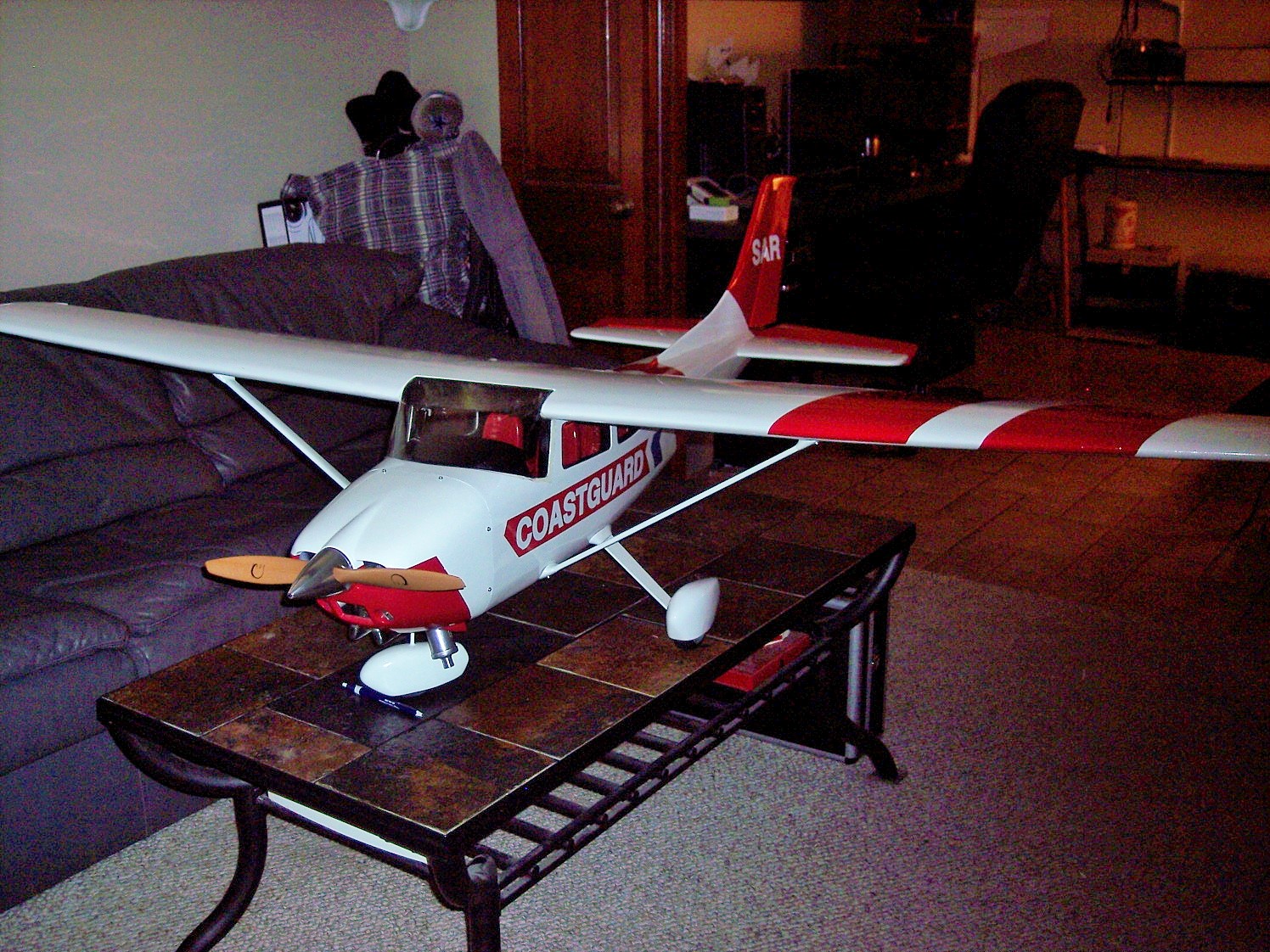

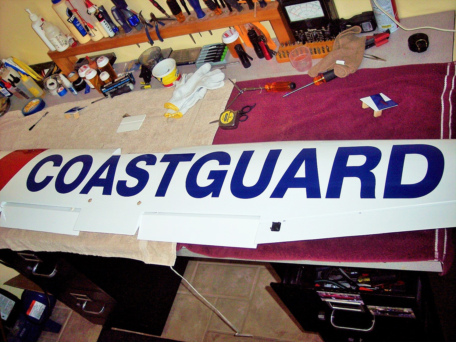

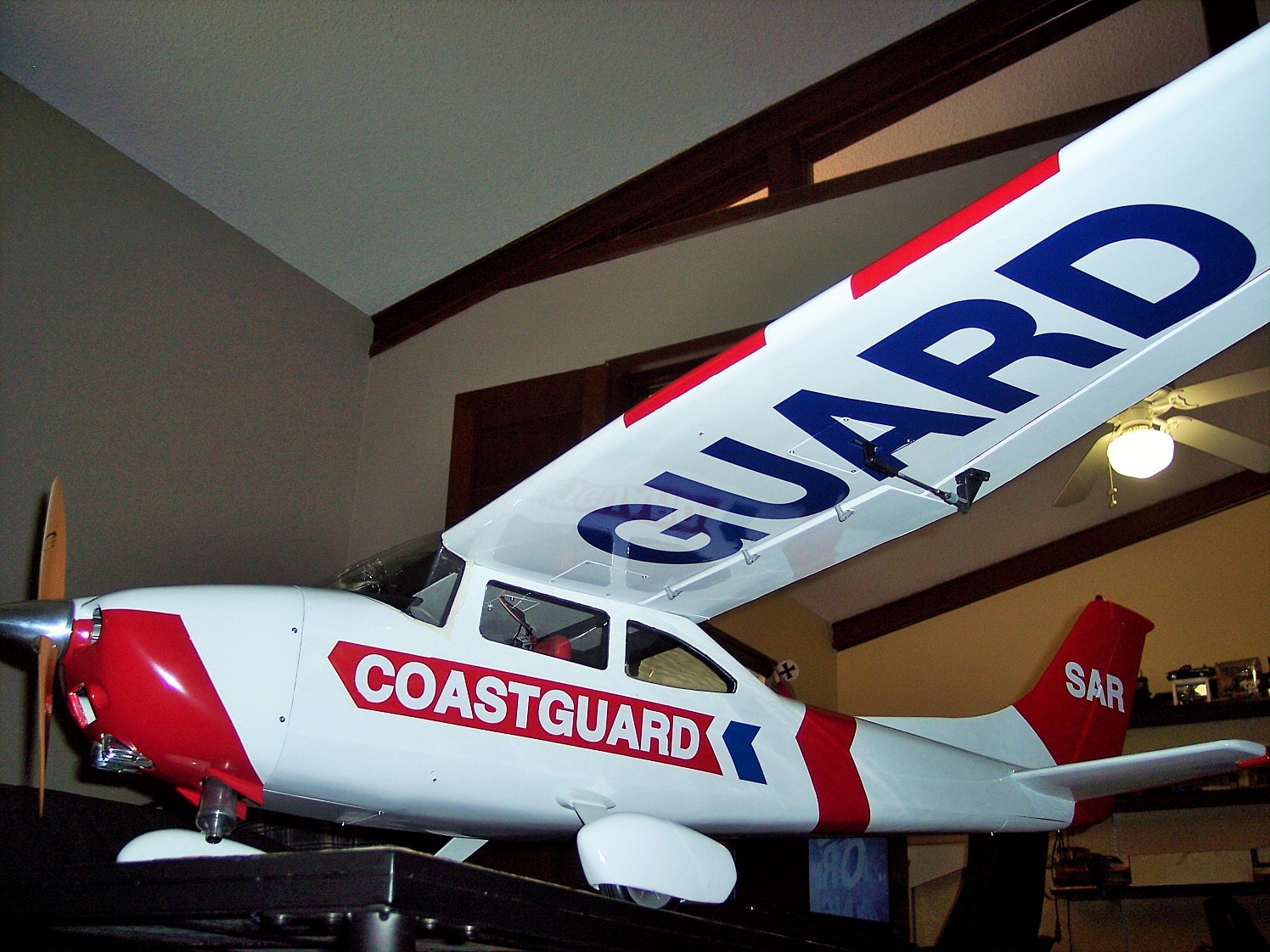

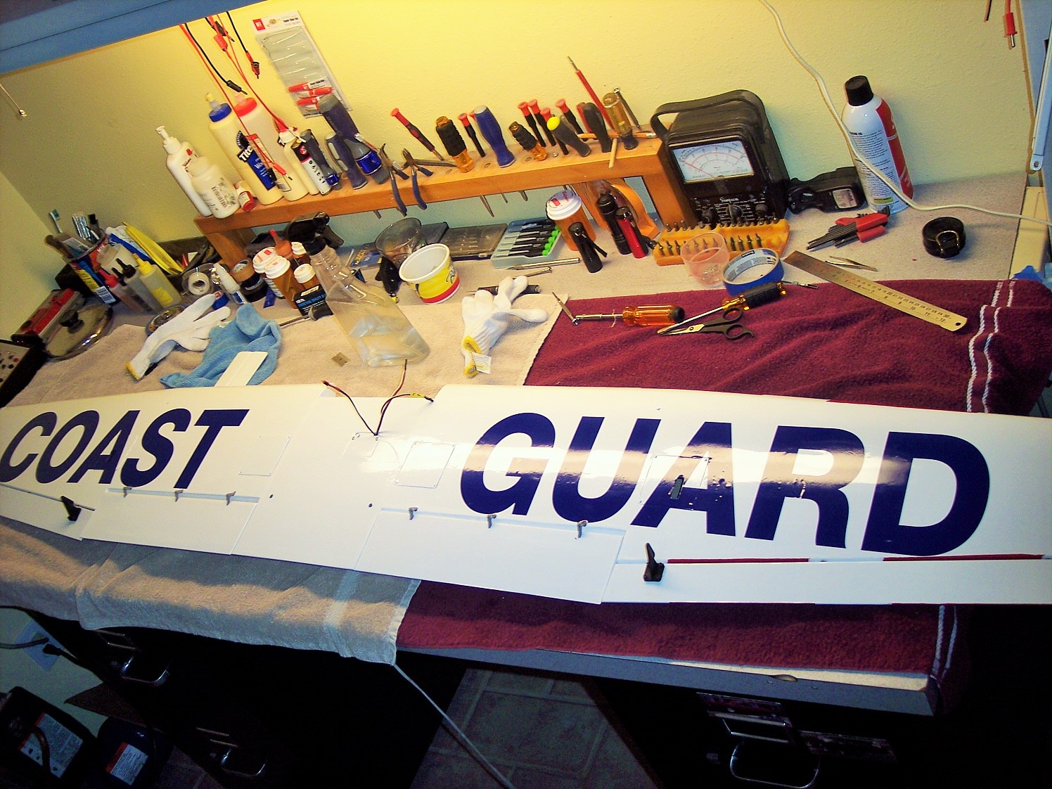

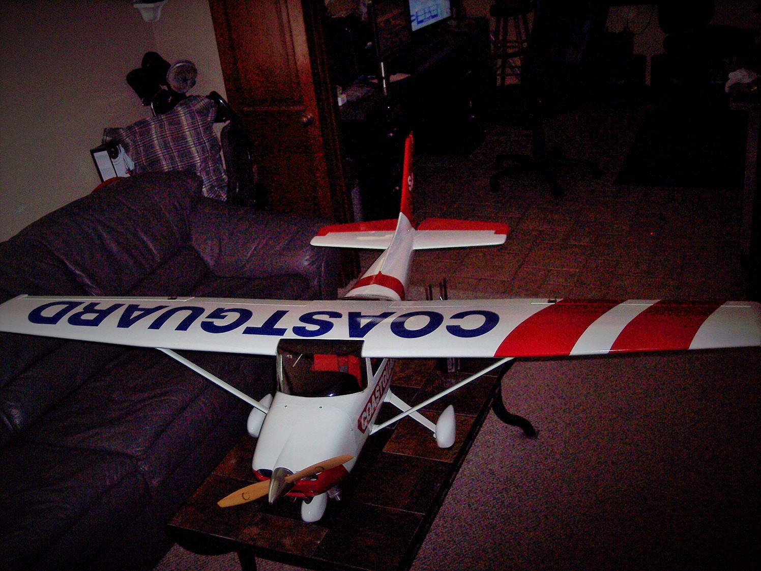

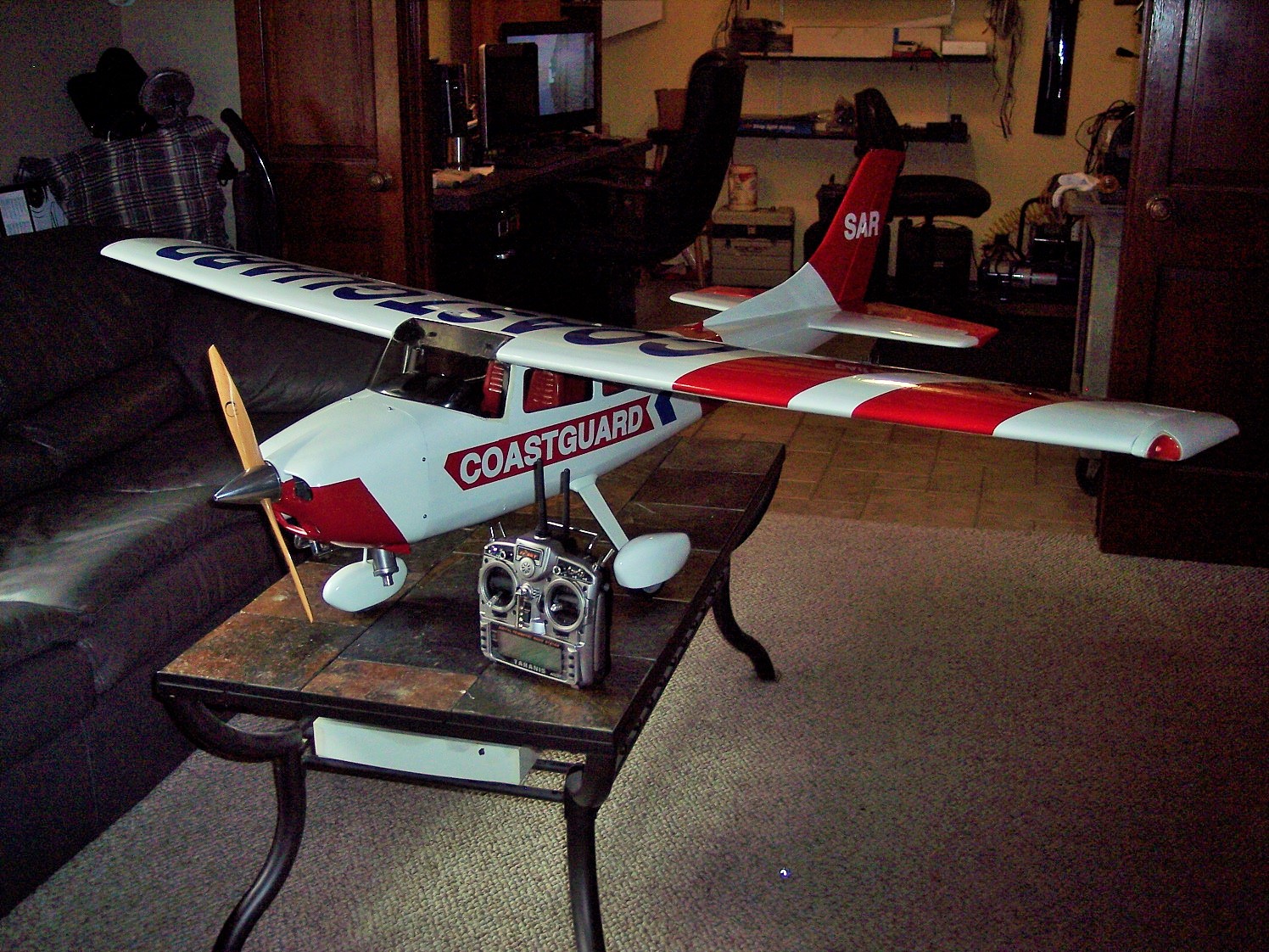

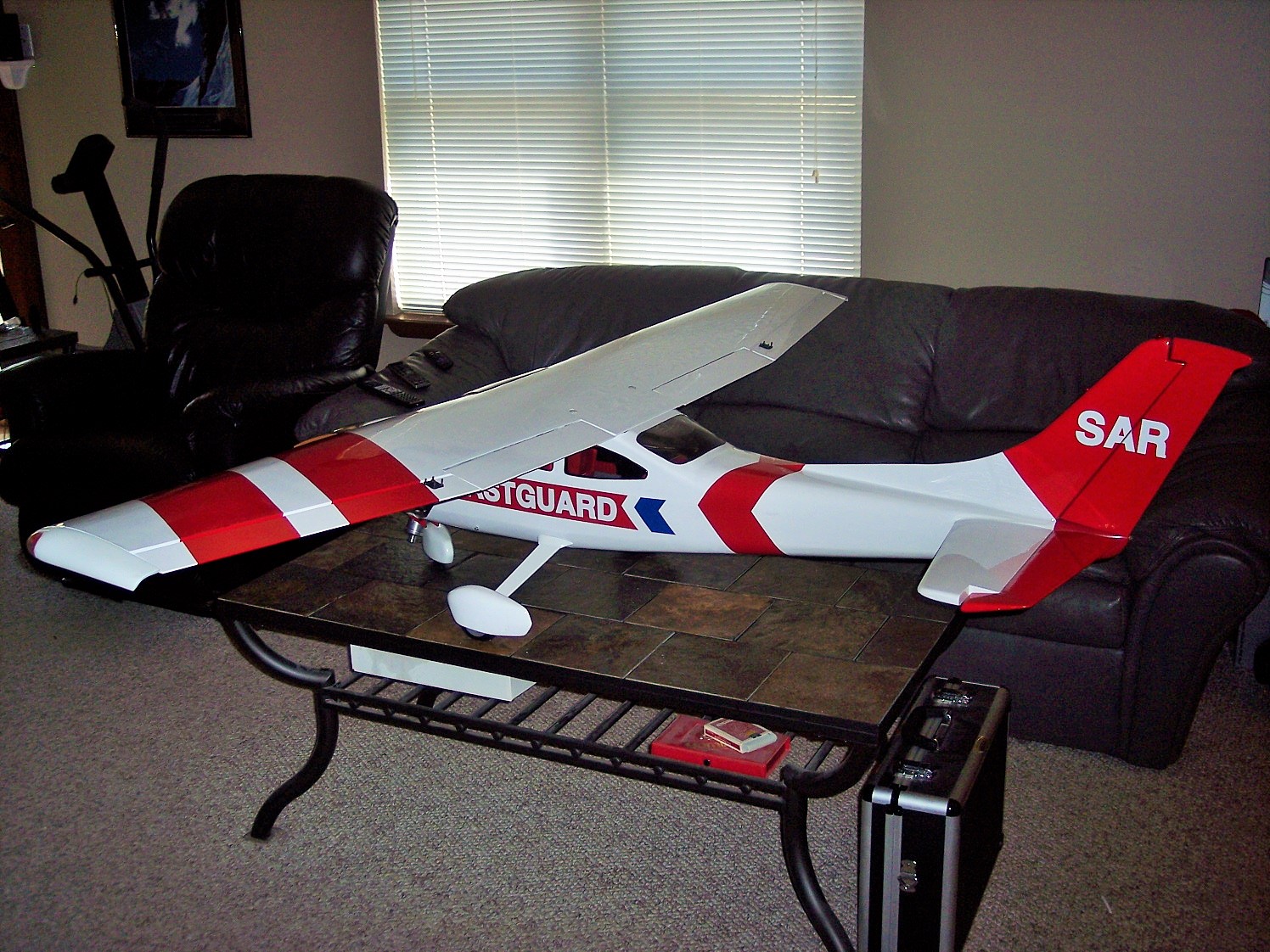

Well I almost got'er done. :D I installed all the wing hardware and test fitted the wing with the wing struts in place, and checked the CG. I must be living right, It was SPOT ON . No weights required. And the GREAT NEW, I weighted the plane ,And the dry weight was only 12.67 LBS ready to fly ,less fuel. The Satio 180 in it gets 16 lbs. of thrust. I still need to put the Coastguard lettering on and program my Taranis radio. Here is some of the latest pictures.

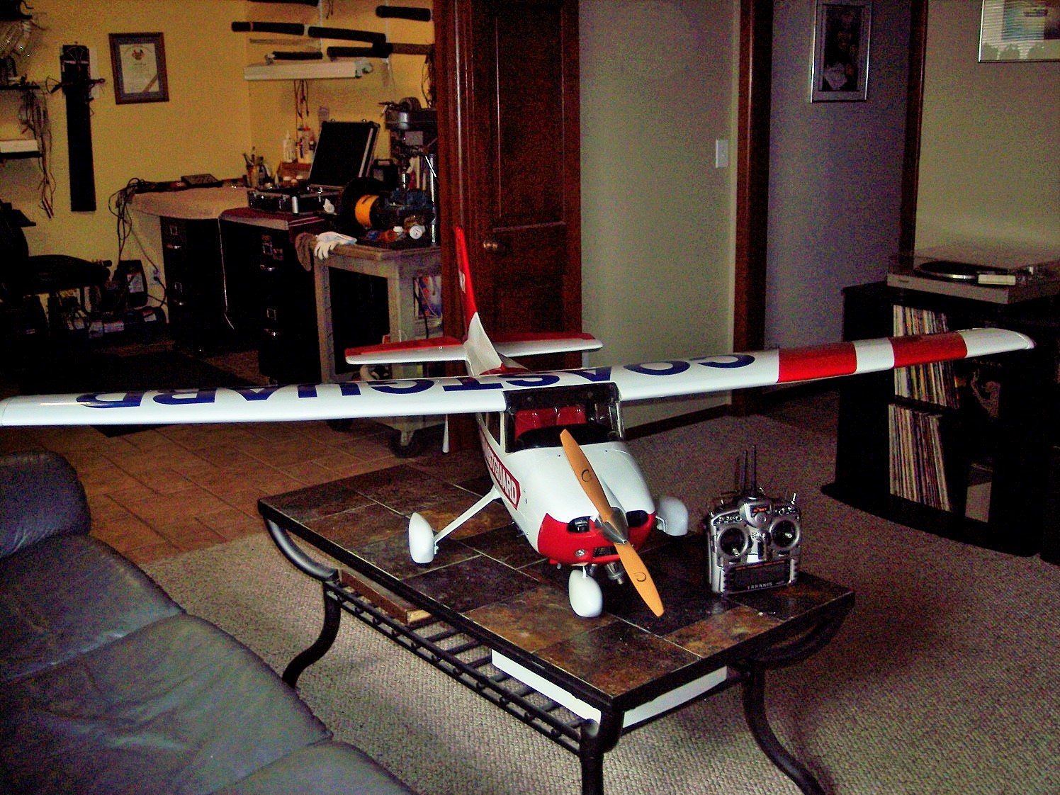

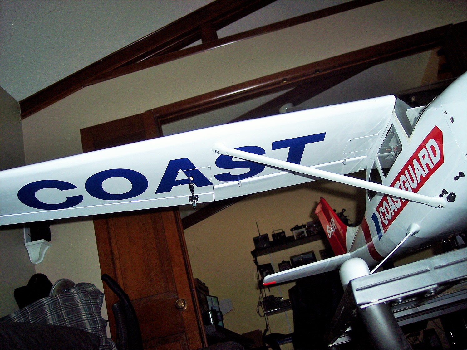

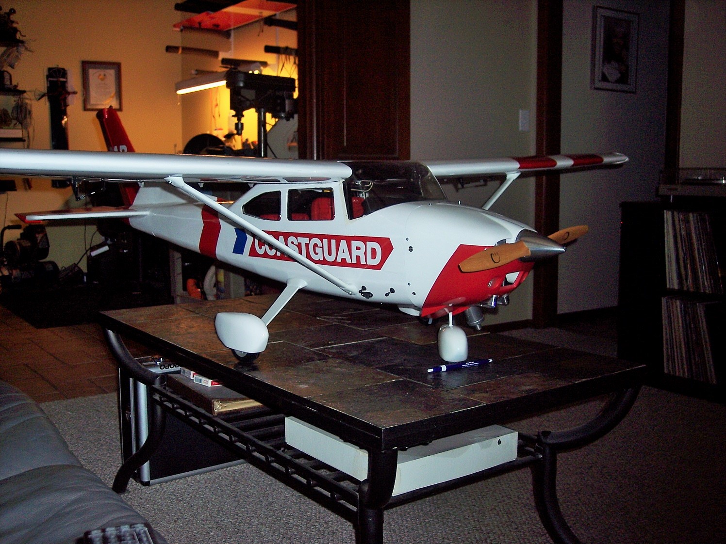

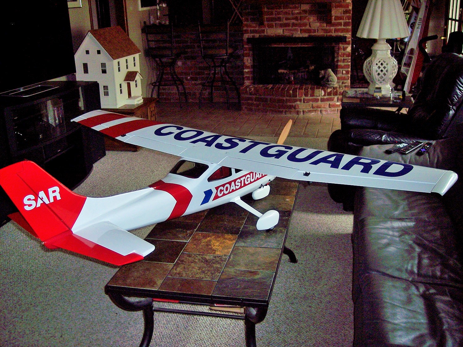

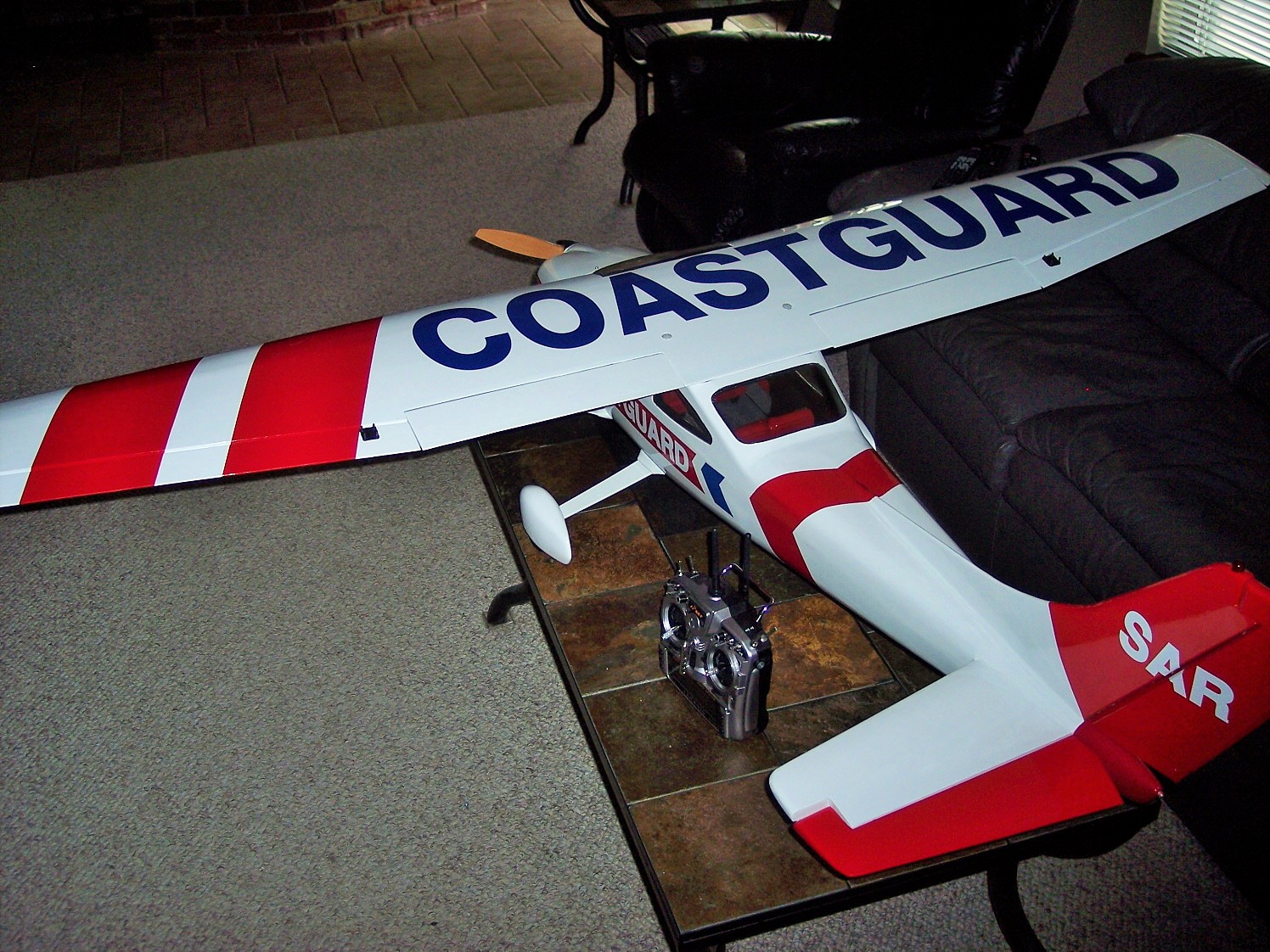

OK the Day is finally here!! :roll: The Cessna is FINISHED!!! As soon as I check the programing on the Taranis Radio it will be ready to fly. Here some of the final pictures.

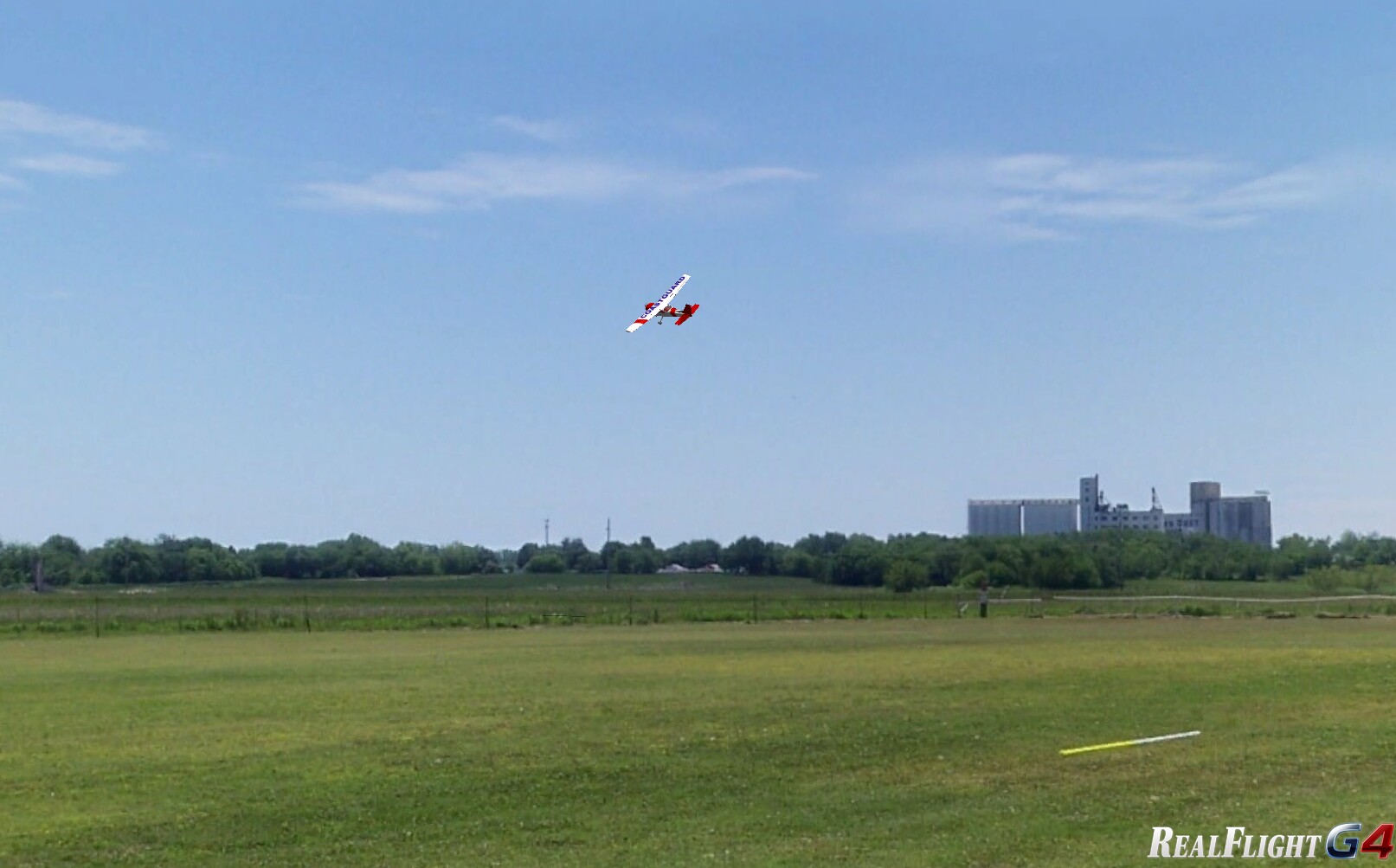

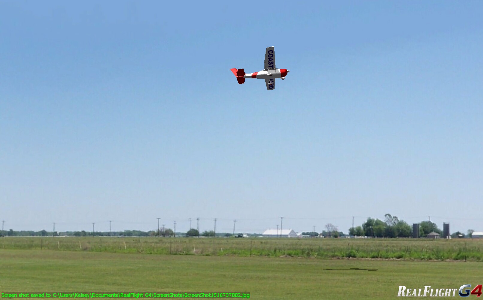

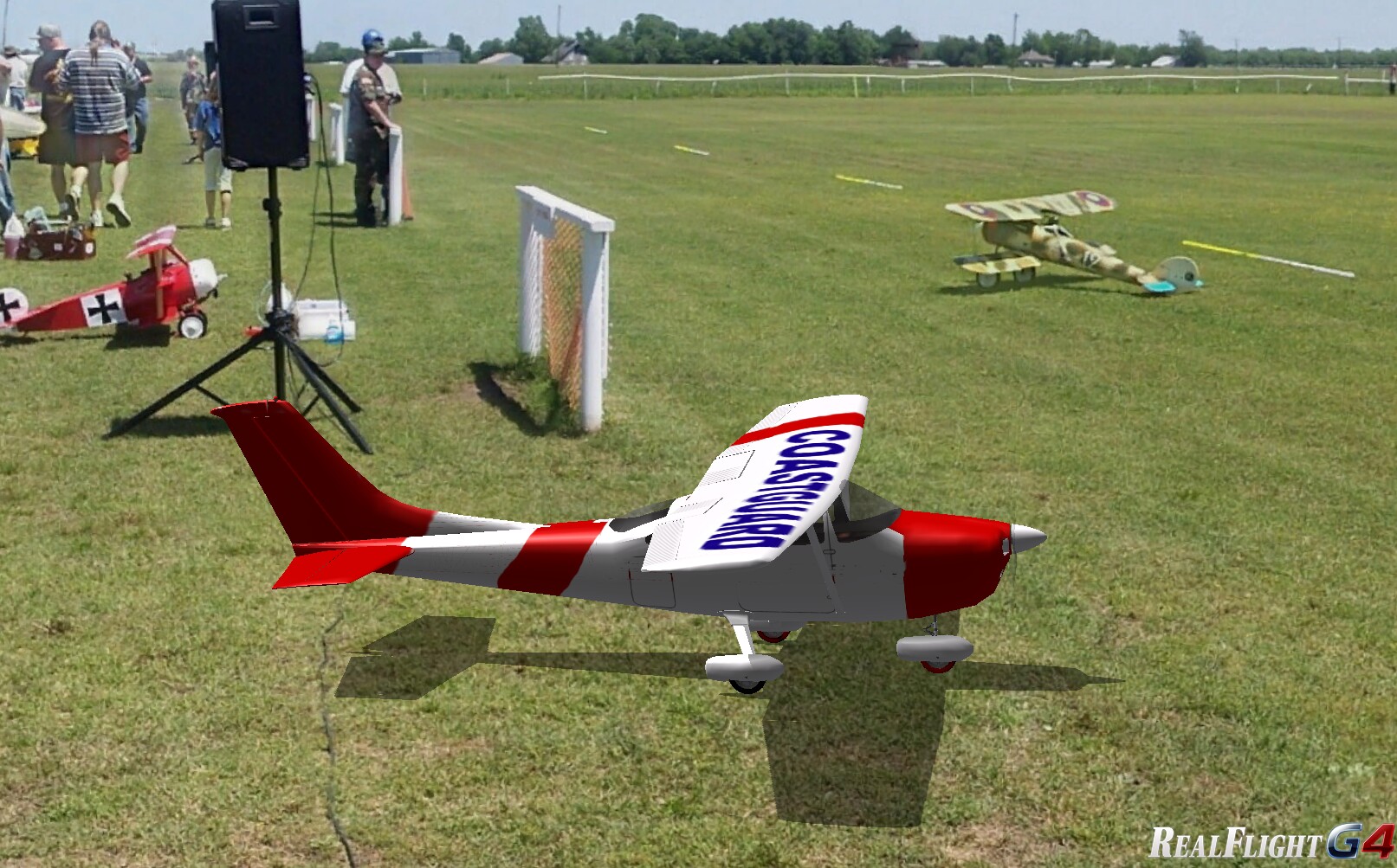

I've been flying the Cessna on Realflight sim to get ready to fly it. I will probably wait till spring when it warms up .
Here is some screenshots from Realflight.
